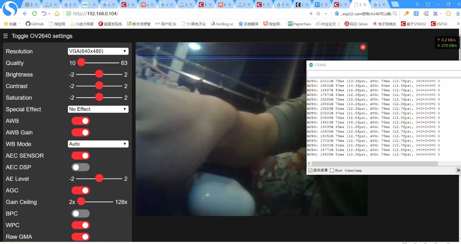

已经成功了的工程文件分享给大家。可能需要的环境搭建教程(点替换成.)www点wzyrr520点xyz/blog/post/admin/ESP32-CAM-Arduino-IDE

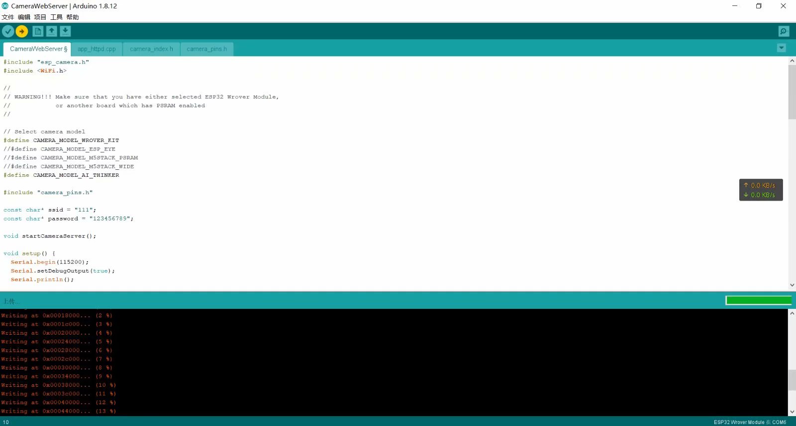

  1. #include "esp_camera.h"
  2. #include <WiFi.h>
  3. //
  4. // WARNING!!! Make sure that you have either selected ESP32 Wrover Module,
  5. //            or another board which has PSRAM enabled
  6. //
  7. // Select camera model
  8. //#define CAMERA_MODEL_WROVER_KIT
  9. //#define CAMERA_MODEL_ESP_EYE
  10. //#define CAMERA_MODEL_M5STACK_PSRAM
  11. //#define CAMERA_MODEL_M5STACK_WIDE
  12. #define CAMERA_MODEL_AI_THINKER
  13. #include "camera_pins.h"
  14. const char* ssid = "2307";
  15. const char* password = "88888888";
  16. void startCameraServer();
  17. void setup() {
  18.   Serial.begin(115200);
  19.   Serial.setDebugOutput(true);
  20.   Serial.println();
  21.   camera_config_t config;
  22.   config.ledc_channel = LEDC_CHANNEL_0;
  23.   config.ledc_timer = LEDC_TIMER_0;
  24.   config.pin_d0 = Y2_GPIO_NUM;
  25.   config.pin_d1 = Y3_GPIO_NUM;
  26.   config.pin_d2 = Y4_GPIO_NUM;
  27.   config.pin_d3 = Y5_GPIO_NUM;
  28.   config.pin_d4 = Y6_GPIO_NUM;
  29.   config.pin_d5 = Y7_GPIO_NUM;
  30.   config.pin_d6 = Y8_GPIO_NUM;
  31.   config.pin_d7 = Y9_GPIO_NUM;
  32.   config.pin_xclk = XCLK_GPIO_NUM;
  33.   config.pin_pclk = PCLK_GPIO_NUM;
  34.   config.pin_vsync = VSYNC_GPIO_NUM;
  35.   config.pin_href = HREF_GPIO_NUM;
  36.   config.pin_sscb_sda = SIOD_GPIO_NUM;
  37.   config.pin_sscb_scl = SIOC_GPIO_NUM;
  38.   config.pin_pwdn = PWDN_GPIO_NUM;
  39.   config.pin_reset = RESET_GPIO_NUM;
  40.   config.xclk_freq_hz = 20000000;
  41.   config.pixel_format = PIXFORMAT_JPEG;
  42.   //init with high specs to pre-allocate larger buffers
  43.   if(psramFound()){
  44.     config.frame_size = FRAMESIZE_UXGA;
  45.     config.jpeg_quality = 10;
  46.     config.fb_count = 2;
  47.   } else {
  48.     config.frame_size = FRAMESIZE_SVGA;
  49.     config.jpeg_quality = 12;
  50.     config.fb_count = 1;
  51.   }
  52. #if defined(CAMERA_MODEL_ESP_EYE)
  53.   pinMode(13, INPUT_PULLUP);
  54.   pinMode(14, INPUT_PULLUP);
  55. #endif
  56.   // camera init
  57.   esp_err_t err = esp_camera_init(&config);
  58.   if (err != ESP_OK) {
  59.     Serial.printf("Camera init failed with error 0x%x", err);
  60.     return;
  61.   }
  62.   sensor_t * s = esp_camera_sensor_get();
  63.   //initial sensors are flipped vertically and colors are a bit saturated
  64.   if (s->id.PID == OV3660_PID) {
  65.     s->set_vflip(s, 1);//flip it back
  66.     s->set_brightness(s, 1);//up the blightness just a bit
  67.     s->set_saturation(s, -2);//lower the saturation
  68.   }
  69.   //drop down frame size for higher initial frame rate
  70.   s->set_framesize(s, FRAMESIZE_QVGA);
  71. #if defined(CAMERA_MODEL_M5STACK_WIDE)
  72.   s->set_vflip(s, 1);
  73.   s->set_hmirror(s, 1);
  74. #endif
  75.   WiFi.begin(ssid, password);
  76.   while (WiFi.status() != WL_CONNECTED) {
  77.     delay(500);
  78.     Serial.print(".");
  79.   }
  80.   Serial.println("");
  81.   Serial.println("WiFi connected");
  82.   startCameraServer();
  83.   Serial.print("Camera Ready! Use 'http://");
  84.   Serial.print(WiFi.localIP());
  85.   Serial.println("' to connect");
  86. }
  87. void loop() {
  88.   // put your main code here, to run repeatedly:
  89.   delay(10000);
  90. }

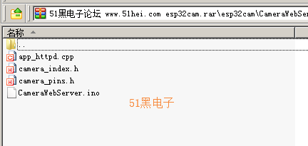

所有资料51hei提供下载:
esp32cam.rar (21 KB, 下载次数: 106)
