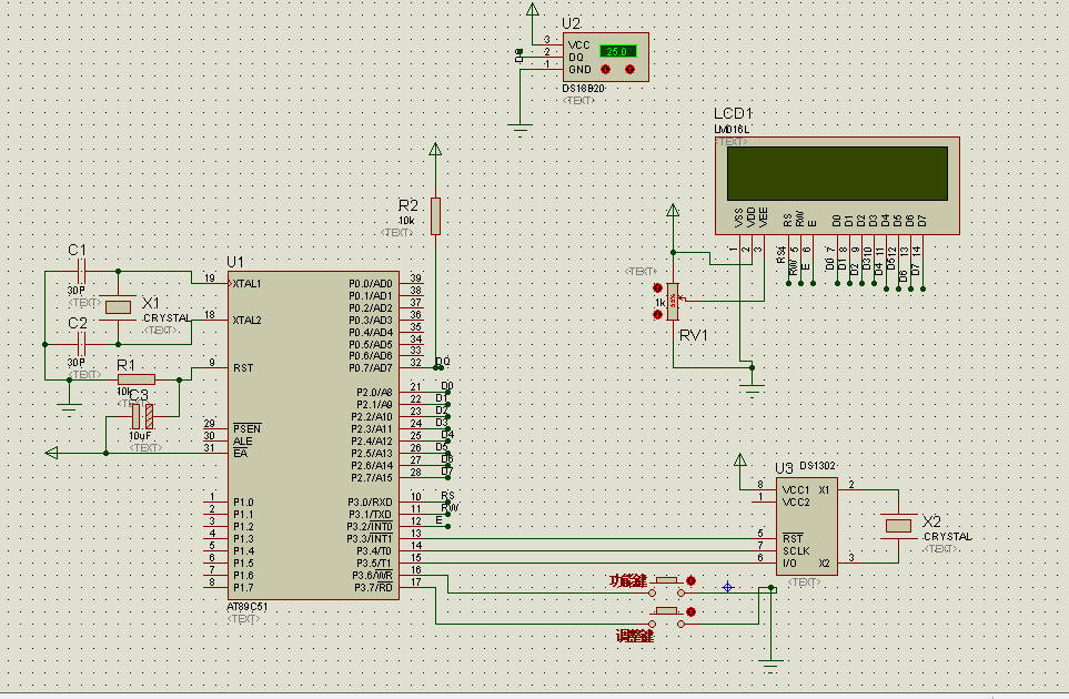

基于51单片机的日历
#include<reg51.h>
#include <intrins.h>
sbit rs= P3^0;
sbit rw= P3^1;
sbit ep= P3^2;
void delay(unsigned char n)         //延时n毫秒
while(n--);
bit lcd_bz()  //检测LCD是否忙
  bit result;
  rs=0;
  rw=1;
  ep=1;
  _nop_();
  _nop_();
  _nop_();
  _nop_();
  result=(bit)(P2&0x80);
  ep=0;

#include<reg51.h>
sbit IO=P3^5;
sbit CLK=P3^4;
sbit RST=P3^3;

#include<reg51.h>
sbit DQ=P0^7;
int k=1;

#include<reg51.h>
#define Adjust(Item,Max,Min)do{unsigned char temp;temp=(Item>>4)*10;temp+=Item&0x0f;if(++temp==Max)temp=Min;Item=temp/10*16;Item+=temp%10;}while(0)
sbit K1=P3^6;
sbit K2=P3^7;
unsigned char code du[]={0x10,6,9,8,8,9,6,0};
unsigned char code year[]={8,31,2,15,10,31,2,0};
unsigned char code mouth[]={15,9,15,9,15,9,19,0};
unsigned char code day[]={15,9,9,15,9,9,15,0};
unsigned char s,c;
bit f;
unsigned char datatime[7];
unsigned char displaybuffer[32];
unsigned char week[7][3]={"SUN","MON","TUS","WED","THR","FRI","SAT"};
unsigned int t;
extern void gettime(unsigned char *);
extern void settime(unsigned char *);
extern void lcd_init();
extern void lcd_wdat(unsigned char);
extern void lcd_wcmd(unsigned char);
extern void delay(unsigned char);
extern unsigned int readt(void);
extern int k;
void display()
        unsigned char i;
        displaybuffer[0]='0'+2;
        displaybuffer[1]='0'+0;
