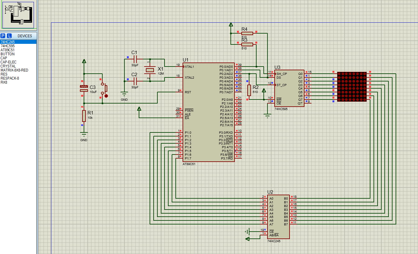

求帅气且富有经验老哥们帮忙看看为啥不亮
* Processor: AT89C51
* Compiler:  Keil for 8051
#include <reg51.h>
#include <stdio.h>
#define uchar unsigned char
#define uint unsigned int
#define ulong unsigned long
sbit MOSIO=P0^0;
sbit R_CLK=P0^2;
sbit S_CLK=P0^1;
void HC595senddata(uchar BTO)
   uchar i;
   for(i=0;i<8;i++)
      MOSIO=BTO>>7;
      BTO<<=1;
      S_CLK=0;
      S_CLK=1;
      R_CLK=0;
      R_CLK=1;
      R_CLK=0;
void delayms(unsigned int i)
   unsigned char k;
   while(i--)
   for(k=0;k<120;k++);//120次空操作
   void main(void)
      unsigned char code led[]={0xff,0xe7,0xc7,0xe7,0xe7,0xe7,0xe7,//1
    0xff,0x87,0xf3,0xc7,0x9f,0x9f,0x9f,//2
    0xff,0x87,0xf3,0xc7,0xf3,0xf3,0xf3,//3
    0xff,0xf3,0xe3,0xd3,0xb3,0xf3,0xf3,//4
    0xff,0x87,0xbf,0x87,0xf3,0xf3,0x87};//5
      unsigned char w,i,j,k,m;
  for(k=0;k<32;k++)//K循环32次
  for(m=0;m<100;m++)
     m=0x01;
     j=k;
     for(i=0;i<8;i++)
        P0=w;
     HC595senddata(led[j]);
        delayms(2);
        HC595senddata(0xff);
        w<<1;
        j++;
        if(j>31)j=j-32;
