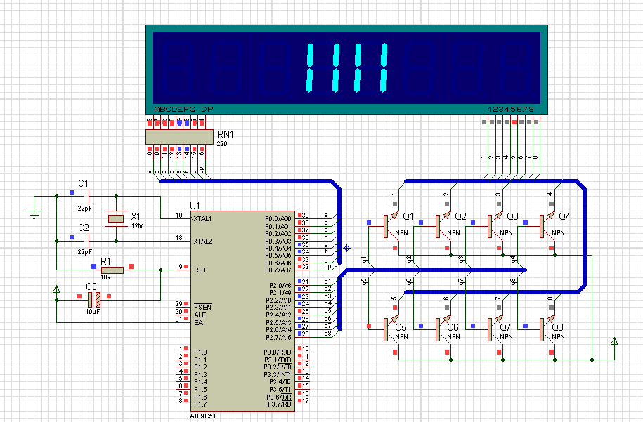

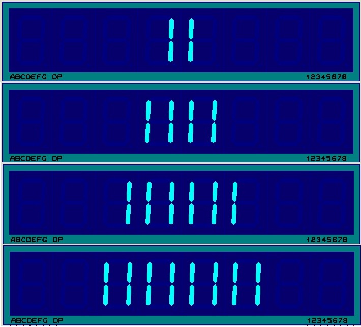

ID:568565 发表于 2020-7-5 20:09 | 只看该作者
这样的效果?

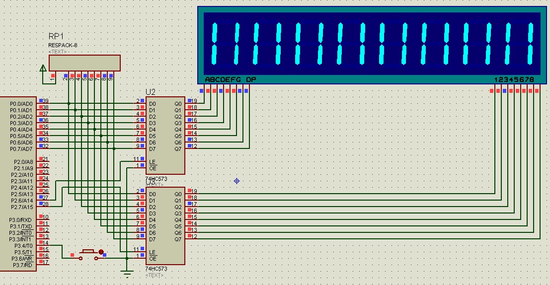

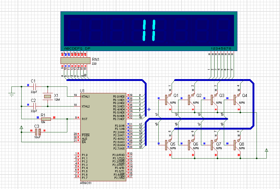

ID:213173 发表于 2020-7-5 21:45 | 只看该作者
  1. #include<reg51.h>
  3. sbit S1=P3^4;
  4. sbit dula=P2^6;
  5. sbit wela=P2^7;
  6. uchar code table[9][8]={
  7. 0x00,0x00,0x00,0x80,0x00,0x00,0x00,0x00,
  8. 0x00,0x00,0x00,0x06,0x30,0x00,0x00,0x00,
  9. 0x00,0x00,0x00,0x36,0x36,0x00,0x00,0x00,
  10. 0x00,0x00,0x06,0x36,0x36,0x30,0x00,0x00,
  11. 0x00,0x00,0x36,0x36,0x36,0x36,0x00,0x00,
  12. 0x00,0x06,0x36,0x36,0x36,0x36,0x30,0x00,
  13. 0x00,0x36,0x36,0x36,0x36,0x36,0x36,0x00,
  14. 0x06,0x36,0x36,0x36,0x36,0x36,0x36,0x30,
  15. 0x36,0x36,0x36,0x36,0x36,0x36,0x36,0x36};
  16. uchar code weia[8]={0xfe,0xfd,0xfb,0xf7,0xef,0xdf,0xbf,0x7f};
  17. uchar i,j,k;
  18. void delay_ms(uchar z)
  19. {
  20.         uchar i,j;
  21.         for(i=z;i>0;i--)
  22.                 for(j=110;j>0;j--);
  23. }
  24. void keyscan()
  25. {
  26.         if(S1==0)
  27.         {
  28.                 if(++j>10)
  29.                         j=11;
  30.                 if(j==10)
  31.                 {
  32.                         k++;
  33.                         if(k>8)
  34.                                 k=0;
  35.                 }
  36.         }
  37.         else j=0;
  38. }
  39. void display()
  40. {
  41.         P0=0x00;dula=1;dula=0;
  42.         P0=weia[i];wela=1;wela=0;
  43.         P0=table[k][i];dula=1;dula=0;
  44.         i++;i%=8;
  45. }
  46. void main()
  47. {
  48.         while(1)
  49.         {
  50.                 keyscan();
  51.                 display();
  52.                 delay_ms(1);
  53.         }
  54. }
