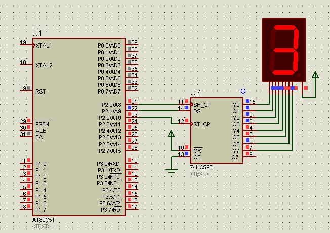

求大神指点一下 用74hc595和中断驱动 一位数码管; 帮忙给看下 万分感谢
#include<reg52.h>
#define uchar unsigned char
#define uint unsigned int
sbit CP = P2^0;
sbit DA = P2^1;
sbit LE = P2^2;
uchar sec,a,b;
uchar code seg[] = {
    0xc0, 0xf9, 0xa4, 0xb0, 0x99,
    0x92, 0x82, 0xf8, 0x80, 0x10};
uchar dis_buff[1] = {0};
void write_595(uchar dat)//д??595
    uchar i;
    for(i = 0; i < 8; i++) {
      DA = dat & 0x80;
    CP = 0;
       CP = 1;
    dat <<= 1;
void update(uchar sec) //
   dis_buff[0] =seg[sec];     // sec ????1????????????????
void display()
  write_595(dis_buff[0]);  //dis_buff[0] ?е????  ????write_595;
  LE = 0;
  LE = 1;      //?????????????
void timer0_isr() interrupt 1   //?ж??????????
TMOD = 0X01;
    TH0 = 0x4c;
EA = 1;
ET0 = 1;
TR0 = 1;
    a++;
if(a%5==0)
b = ~b;
update(); //??sec ????dis_buff[0]?У? ???磺sec = 1?  ??浽dis_buff[0]???У?
    if(a == 20)
  display(); //dis_buff[0] ?е????  ????write_595;
      a = 0;
   sec++;
   if(sec==9) sec = 0;
void timer0_init(void)
    TMOD = 0x01;//T0??????1
    TH0 = 0x4c; //50ms@11.0592MHz
    EA = 1;
ET0 = 1;
TR0 = 1;
void  main()
tiemr0_init();
while(1);

ID:213173 发表于 2020-10-26 08:19 | 只看该作者
赘句多,语句顺序不当。给你整理后运行正常。你仔细对比一下就能明白问题所在。
  1. #include<reg52.h>
  3. #define uint unsigned int
  4. sbit CP = P2^0;
  5. sbit DA = P2^1;
  6. sbit LE = P2^2;
  7. uchar sec,a;
  8. uchar code seg[] = {
  9.     0xc0,0xf9,0xa4,0xb0,0x99,
  10.          0x92,0x82,0xf8,0x80,0x90};
  11. void write_595(uchar dat)
  12. {
  13.         uchar i;
  14.         for(i = 0; i < 8; i++)
  15.         {
  16.                 DA = dat&0x80;
  17.                 CP = 0;
  18.                 CP = 1;
  19.                 dat <<= 1;
  20.         }
  21.         LE = 0;
  22.         LE = 1;
  23. }
  24. void timer0_isr() interrupt 1
  25. {
  26.         TH0=0x4c;
  27.         TL0=0x00;
  28.         a++;
  29.         if(a == 20)
  30.         {
  31.                 a = 0;
  32.                 sec++;
  33.         }
  34.         if(sec>9) sec = 0;
  35.         write_595(seg[sec]);
  36. }
  37. void timer0_init(void)
  38. {
  39.         TMOD = 0x01;
  40.         TH0 = 0x4c; //50ms@11.0592MHz
  41.         TL0 = 0x00;
  42.         EA  = 1;
  43.         ET0 = 1;
  44.         TR0 = 1;
  45. }
  46. void  main()
  47. {
  48.         timer0_init();
  49.         while(1);
  50. }
