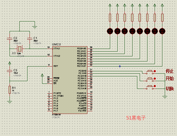

单片机流水灯8个模式 Proteus仿真源程序

//按键停止
sbit key1=P3^0;
//按键开始
sbit key2=P3^1;
//按键切换
sbit key3=P3^2;

#define PP P0
//普通显示
void xianshi0()
PP=~0XFF;
//整体闪烁
void xianshi1()
  jishu1=jishu1+1;if(jishu1>400){jishu1=0;bz1=(bz1+1)%2;}
  PP=~mo1[bz1];
//单字闪烁
void xianshi2()
  jishu1=jishu1+1;if(jishu1>400){jishu1=0;bz2=(bz2+1)%2;}
  PP=~mo2[bz2];
//单字单向移动
void xianshi3()
jishu1=jishu1+1;if(jishu1>400){jishu1=0;bz3=(bz3+1)%8;}
  PP=~mo3[bz3];
//多字单向移动
void xianshi4()
jishu1=jishu1+1;if(jishu1>400){jishu1=0;bz4=(bz4+1)%4;}
  PP=~mo4[bz4];
//多字闪烁
void xianshi5()
jishu1=jishu1+1;if(jishu1>400){jishu1=0;bz5=(bz5+1)%2;}
  PP=~mo5[bz5];
//整体向前
void xianshi6()
jishu1=jishu1+1;if(jishu1>400){jishu1=0;bz6=(bz6+1)%8;}
  PP=~mo6[bz6];
//整体向后
void xianshi7()
jishu1=jishu1+1;if(jishu1>400){jishu1=0;bz7=(bz7+1)%8;}
  PP=~mo7[bz7];
//两边向中间移动、
void xianshi8()
jishu1=jishu1+1;if(jishu1>800){jishu1=0;bz8=(bz8+1)%4;}
  PP=~mo8[bz8];
//中间向两边移动
void xianshi9()
jishu1=jishu1+1;if(jishu1>800){jishu1=0;bz9=(bz9+1)%4;}
  PP=~mo9[bz9];
