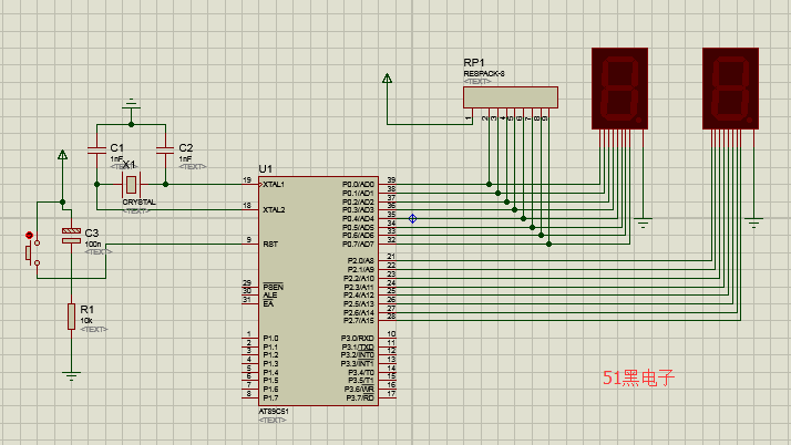

单片机60s计时器程序,自动计时,无返回 求帮助
60s计时器,自动计时,无返回
  1. //0-59自动计数器
  2. //跳线设置:默认
  3. #include<reg51.h>
  4. unsigned char code discode1[]={0x3f,0x06,0x5b,0x4f,0x66,0x6d,0x7d,0x07,0x7f,0x6f};
  5. unsigned char code discode2[]={0x3f,0x06,0x5b,0x4f,0x66,0x6d,0x7d,0x07,0x7f,0x6f};
  6. unsigned char timer=0;
  7. unsigned char second;
  8. main()
  9. {
  10.                 TMOD = 0x01;
  11.                 EA=1;            //总中断打开
  12.                 ET0=1;           //定时器中断打开
  13.                 second=0;
  14.                 TR0=1;
  15.                 P0=discode1[second/10];
  16.                 P2=discode2[second%10];
  17.                 while(1)
  18.                 {
  19.
  20.                 }
  21. }
  22. void int_T0() interrupt 1 using 0
  23. {
  24.         TR0=0;
  25.         TH0=0xee;
  26.         TL0=0x00;
  27.         timer ++;
  28.         if(timer==200)
  29.         {
  30.                 timer = 0;
  31.                 second ++;
  32.                 P0=discode1[second/10];
  33.                 P2=discode2[second%10];
  34.         }
  35.         if(second==60)
  36.         {
  37.                 TR0=0;
  38.                 second=0;
  39.         }
  40.         else
  41.         {
  42.                 TR0=1;
  43.         }
  44. }

ID:838732 发表于 2020-11-28 18:10 | 只看该作者
  //0-59自动计数器
//跳线设置:默认
#include<reg51.h>
unsigned int timer;
void main()
                TMOD = 0x01;
                EA=1;            //总中断打开
                ET0=1;           //定时器中断打开
                second=0;
                TR0=1;
                                   if(second<60)
                                   {P0=~discode1[second/10];
                   P2=~discode2[second%10];
                   else if(second==60)
                                   {second=0;}
                TH0=0xee;
        TL0=0x00;
        timer ++;
        if(timer==200)
                timer = 0;
                second ++;
我改了下程序,我的电路是共阳的,所以取反,测试时可行的,你试试

ID:535215 发表于 2020-11-28 18:28 | 只看该作者
#include<reg51.h>
unsigned int timer;
void main()
                TMOD = 0x01;
                EA=1;            //总中断打开
                ET0=1;           //定时器中断打开
                second=0;
                TR0=1;
                                   if(second<60)
                                   {P0=discode1[second/10];
                   else if(second==60)
                                   {second=0;}
                TH0=0xee;
        TL0=0x00;
        timer ++;
        if(timer==200)
                timer = 0;
                second ++;
按照这个来 你试一试
