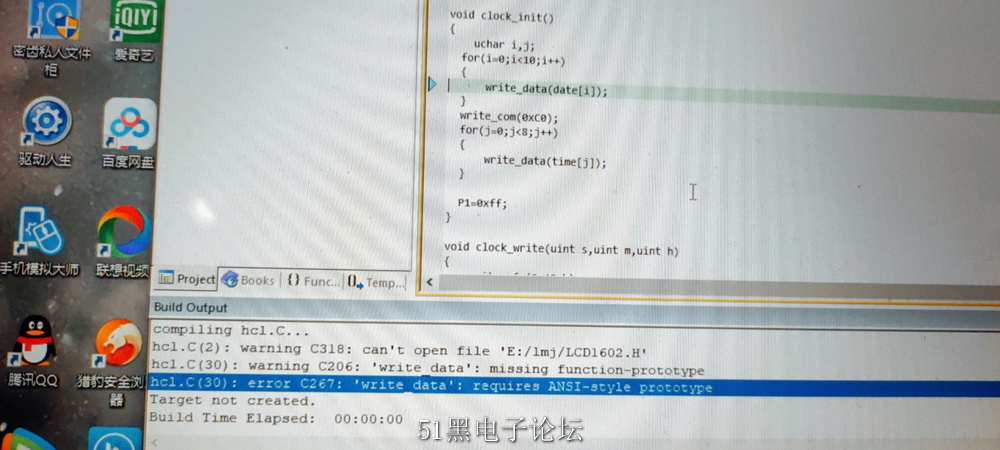

Keil报错error C267 请大神告知解决方法,谢谢!

  1. #include<reg51.h>
  2. #include<E:/lmj/LCD1602.H>
  4. #define uint unsigned int
  5. sbit K1=P1^0;
  6. sbit K2=P1^1;
  7. sbit K3=P1^2;
  8. sbit K4=P1^3;
  9. uchar int_time;
  10. uchar minute;
  11. uchar hour;
  12. uchar code date[]="LuoMengJie";
  13. uchar code time[]="23:59:55";

头文件:

ID:466730 发表于 2020-12-27 01:43 | 只看该作者
头文件没有加进去,<>换成"",一般用相对路径就可以了吧
