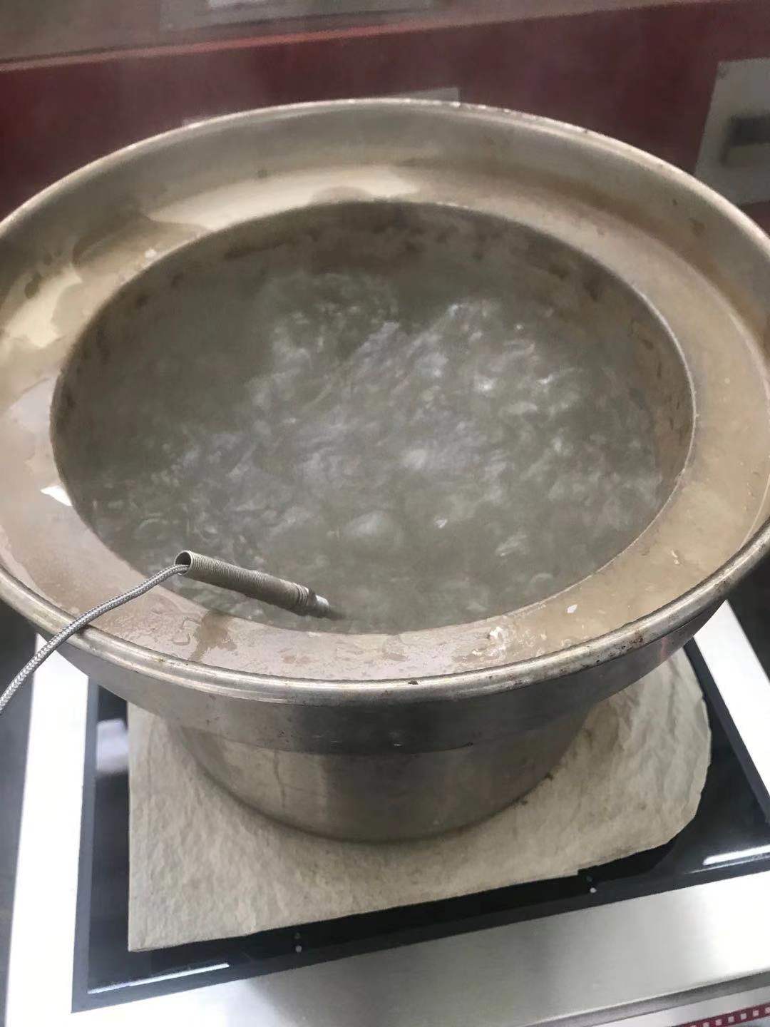

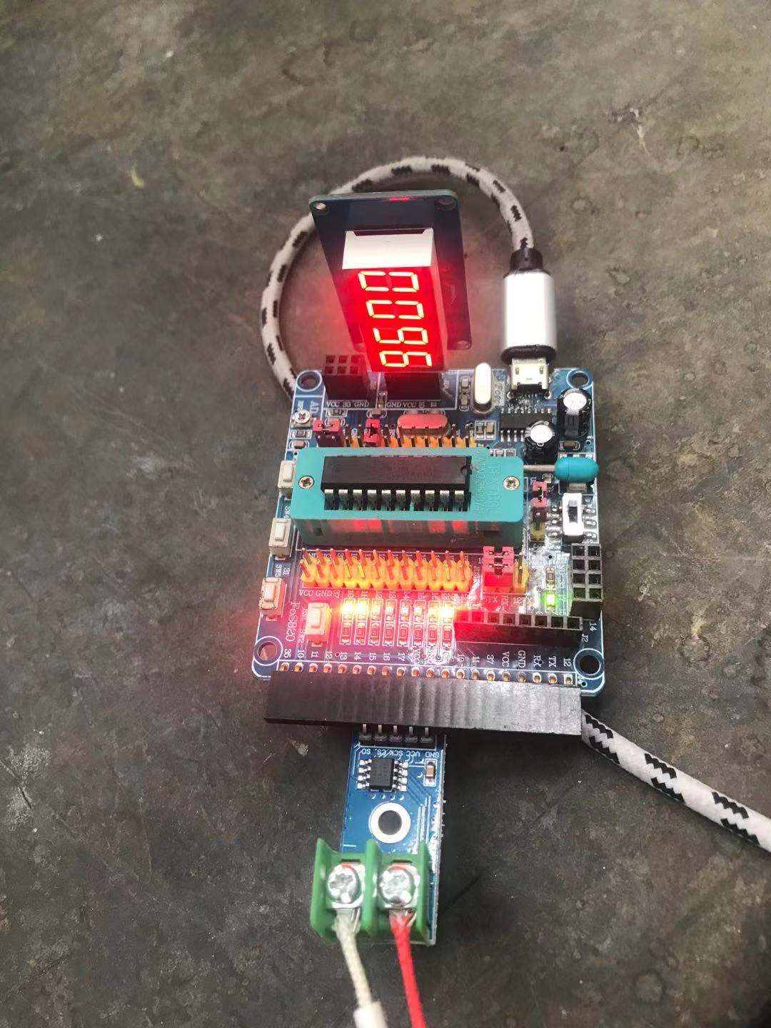

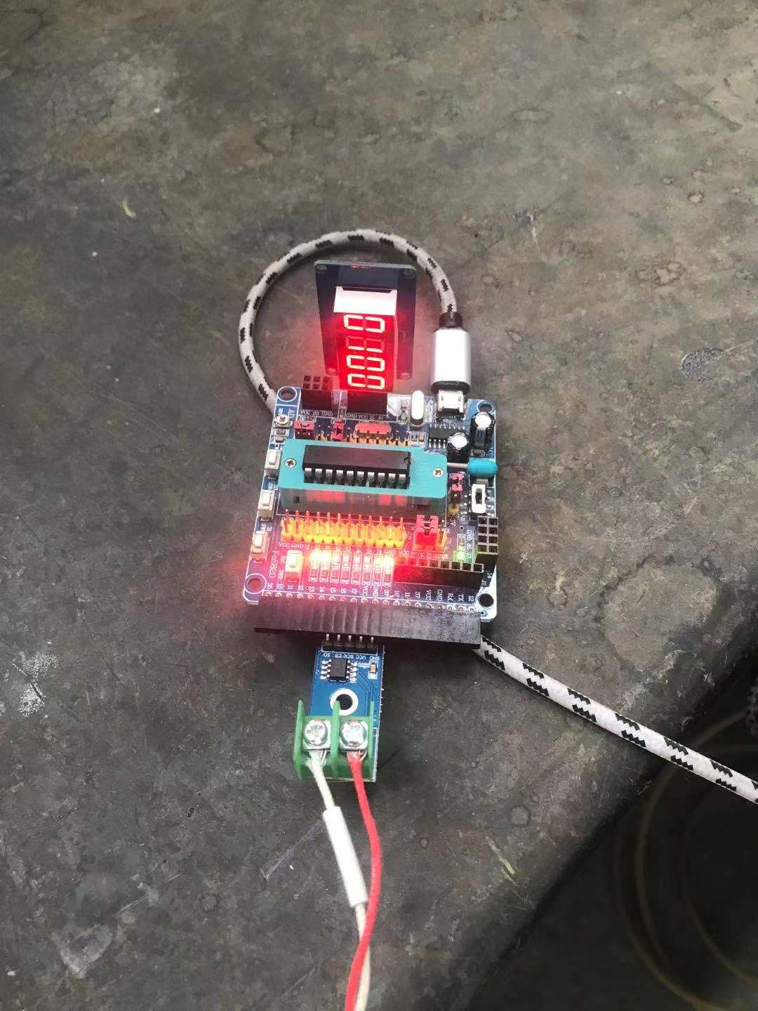

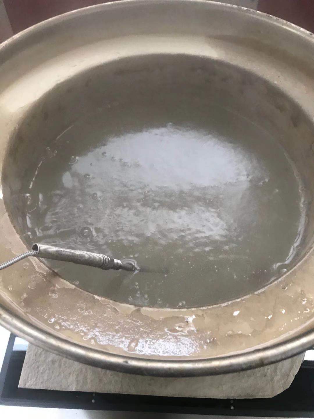

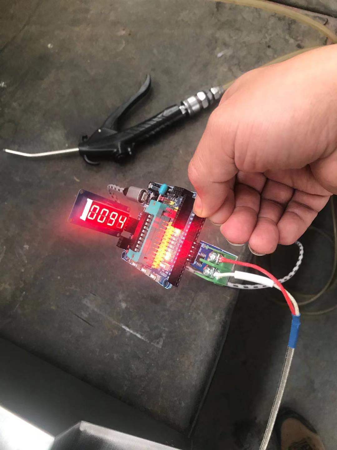

制作出来的实物图如下:

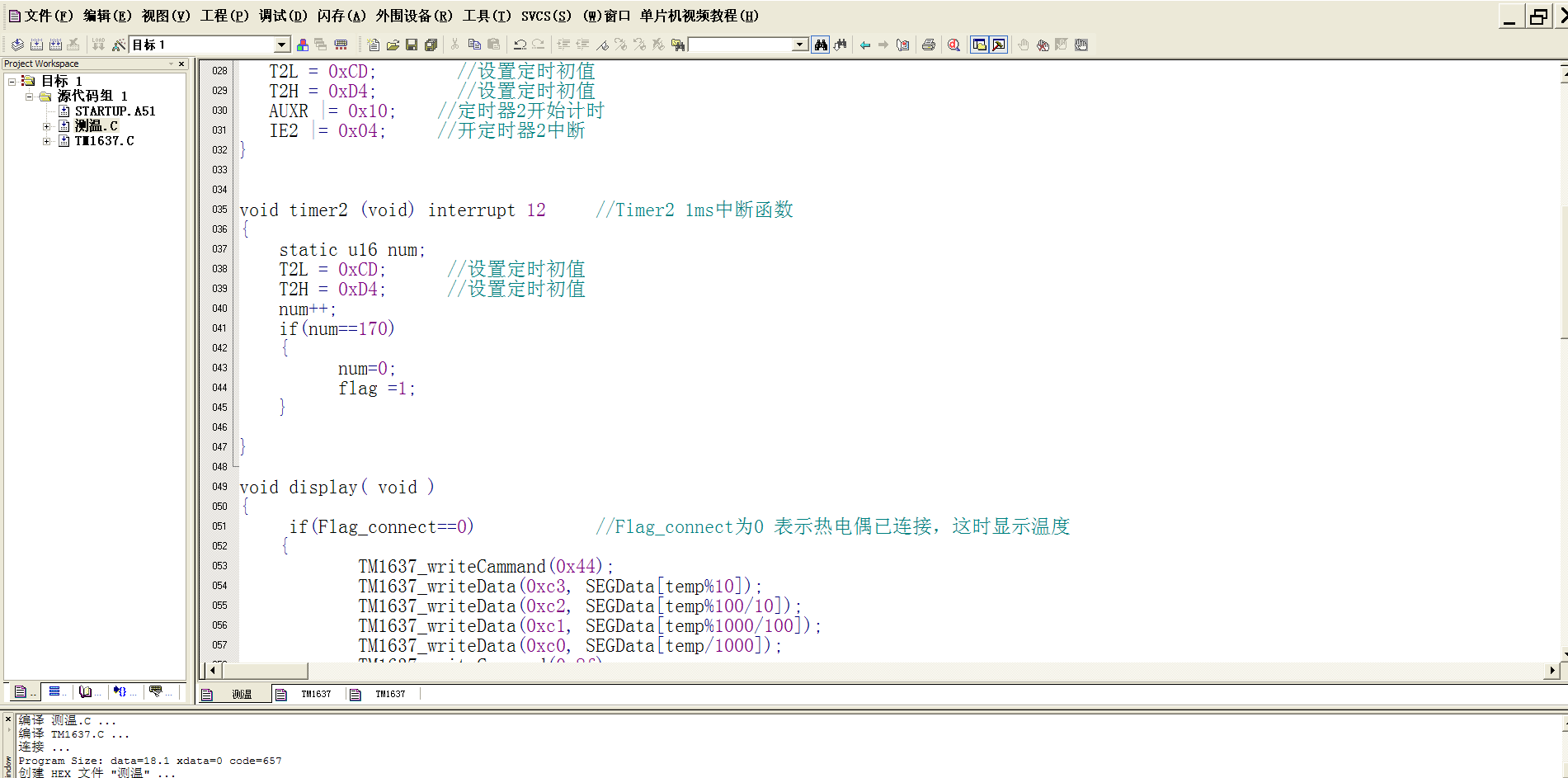

  1. #include "stc15.h"  //reg51.h
  2. #include "intrins.h"
  3. #include  "TM1637.h"
  4. typedef unsigned char u8;
  5. typedef unsigned int u16;
  6. sbit    SO            = P3^6;
  7. sbit    SCK           = P1^0;
  8. sbit    CS            = P3^7;
  9. /*------定义驱动数码管的片选表和断码表---------------*/
  10. /***************************数码管段选表*************************/
  11. unsigned char code SEGData[]={0x3f,0x06,0x5b,0x4f,0x66,0x6d,0x7d,0x07,0x7f,0x6f,0x73,0x40,0x00,0x39};
  12.                    //  0    1    2    3    4    5    6    7    8    9    P     -   灭    C
  13. unsigned char code SEGDataDp[]={0xbf,0x86,0xdb,0xcf,0xe6,0xed,0xfd,0x87,0xff,0xef};
  14.                    //有小数点只用于地址0xc1
  15. u16 temp,temp_1,t;
  16. u8  Flag_connect;
  17. bit flag;
  18. /******************定时器相关程序**********************/
  19. void time2_init(void) //定时器2初始化
  20. {
  21.    AUXR |= 0x04;    //使用模式1,16位定时器,使用"|"符号可以在使用多个定时器时不受影响
  22.    T2L = 0xCD;                  //设置定时初值
  23.    T2H = 0xD4;                  //设置定时初值
  24.    AUXR |= 0x10;    //定时器2开始计时
  25.    IE2 |= 0x04;     //开定时器2中断
  26. }
  27. void timer2 (void) interrupt 12         //Timer2 1ms中断函数
  28. {
  29.         static u16 num;
  30.         T2L = 0xCD;                 //设置定时初值
  31.         T2H = 0xD4;                 //设置定时初值
  32.     num++;
  33.     if(num==170)
  34.     {
  35.           num=0;
  36.                   flag =1;
  37.     }
  38.
  39. }
  40. void display( void )
  41. {
  42.      if(Flag_connect==0)                          //Flag_connect为0 表示热电偶已连接,这时显示温度
  43.         {
  44.                         TM1637_writeCammand(0x44);
  45.                         TM1637_writeData(0xc3, SEGData[temp%10]);
  46.                     TM1637_writeData(0xc2, SEGData[temp%100/10]);
  47.                         TM1637_writeData(0xc1, SEGData[temp%1000/100]);
  48.                         TM1637_writeData(0xc0, SEGData[temp/1000]);
  49.                         TM1637_writeCammand(0x8f);
  50.         }
  51.         else
  52.         {
  53.                         TM1637_writeCammand(0x44);
  54.                         TM1637_writeData(0xc0, SEGData[16]);
  55.                     TM1637_writeData(0xc1, SEGData[16]);
  56.                         TM1637_writeData(0xc2, SEGData[16]);
  57.                         TM1637_writeData(0xc3, SEGData[16]);
  58.                         TM1637_writeCammand(0x8f);
  59.         }
  60. }
