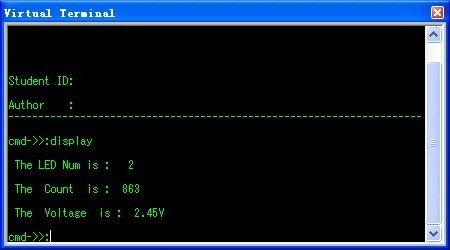

超级终端通信配置超级终端
波特率9600,数据位8位,无奇偶校验,停止位1位,无数据流如图2,5所示:

2.5.2 超级终端命令
COMMAND CommandList[MAX_COMMAND_NUM]= {
       {"help",Help," help -----Command help"},
       {"set",Set," set <clearor led><num> ----- Change LED or Count"},
       {"display",Display,"display ----- Display LED Count Voltage"},
       {"reboot",Reboot," reboot----- Reboot the MCU"},
};    //指令;指令函数;帮助;
voidRunHyperTerminal()
       if(ExecCommandFlag)
              ExecCommand(&SerialBuffer[0]);
              SerialSendStr(&PromptBuffer[0]);
              memset(&SerialBuffer[0],'\0',MAX_SERIAL_BUFFER_SIZE);
              CursorPosion = 0;
              ExecCommandFlag = 0;
cmd->>:help
help ----- Command help
set <clear or led><num> -----Change LED or Count
reboot ----- Reboot the MCU
cmd->>:display
The LED Num is :   3
The Count  is :  5
The Voltage  is :  2.70V
cmd->>:setclear
The Count is clear!
cmd->>:setled 1
The LED stat is change!
                  图2.6  超级终端

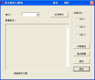

  MFC上位机设计收发数据函数
下面是数据接收、发送的函数:

void CSerialCommunicationDlg::OnBnClickedButtonClear()
    //TODO: 在此添加控件通知处理程序代码
    CString str;
    str="setclear";
    //将数据写入串口
    intnLen = (str.GetLength() + 1) * sizeof(TCHAR);
    m_com.WriteData((byte*)(LPCTSTR)str, nLen);
配对串口
通过串口(软件配对串口COM1-COM2,如图2.6所示)连接proteus单片机系统;COM1连接proteus,COM2连接超级终端或MFC上位机;
图2.7 配对串口
仿真结果
实现控制单片机系统的led状态、计数复位、显示数据和复位功能,其效果如图2.8所示:
图2.8  MFC界面
