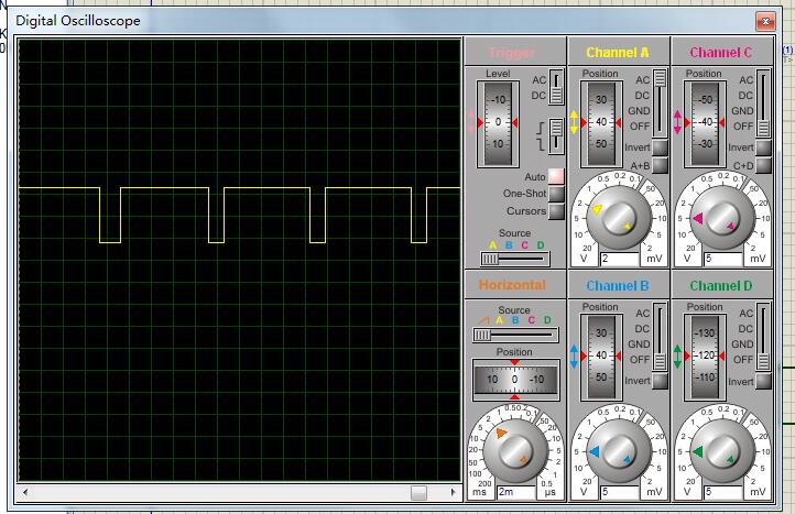

经典单片机两定时器控制呼吸灯程序与Proteus仿真
#include <reg52.h>
#define        uchar  unsigned char
#define        uint   unsigned int
#define        ulong  unsigned long
ulong cnt;
uint  cnt_T1,   high,  low;
uchar TH0_H, TL0_H,  TH0_L,  TL0_L,  T1H1,    T1L1,  flag = 0;
uchar duty[19] = {5,10,15,20,25,30,35,40,45,50,55,60,65,70,75,80,85,90,95};
sbit out = P3^7;
uchar shuying = 0;
void delay_fy(uchar fy, uchar dy);
void time_1(uchar ms);
void sm_du(uchar dy);
void main()
    TMOD = 0X11;    //  定时器0/1都工作在方式1,是2^16计数
    EA=1;
    delay_fy(100, 5);
    time_1(50);
    while(1);
void delay_fy(uchar fy, uchar dy)   // 输入频率fy,占空比dy
    cnt =  (11059200/fy)/12;        //  要产生频率为fy,定时器0所要计的数值
    high = (cnt*dy)/100;            //  计算出高电平所要计的数值
    low = cnt - high;               //  计算出低电平所要计的数值
    high = 65536 - high;            //  确定定时器0,从哪个初值开始计时,记录的是高电平
    low = 65536 - low;              //  确定定时器0,从哪个初值开始计时,记录的是低电平
    TH0_H = (uchar)(high>>8);    //  高电平,给TH0预备重装初值
    TL0_H = (uchar)high;         //  高电平,给TL0预备重装初值
    TH0_L = (uchar)(low>>8);      //  低电平,给TH0预备重装初值
    TL0_L = (uchar)low;           //  低电平,给TL0预备重装初值
    TH0 = TH0_H;
    TL0 = TL0_H;
    out = 1;
    ET0 = 1;
    TR0 = 1;
    ulong temp;
    temp =  11059200/1000;
    temp = (temp*ms)/12;
    cnt_T1 = 65536 - temp;
    T1H1 = (uchar)(cnt_T1>>8);
    T1L1 = (uchar)cnt_T1;
    TH1 = T1H1;
    TL1 = T1L1;
    ET1=1;
    TR1=1;
    low = cnt - high;
    low  = 65536 - low;
void time_0() interrupt 1
    if(out==0)  //  准备产生高电平
        TH0 = TH0_H;         //  高电平产生  初值重装
        TL0 = TL0_H;
        out = 1;
    else
        TH0 = TH0_L;         //  低电平产生  初值重装
        TL0 = TL0_L;
        out = 0;
void T1_Timer1() interrupt 3
    TH1 = T1H1;
    TL1 = T1L1;
    sm_du(duty[shuying]);
    if(0 == flag)   //  flag=0时,表示呼吸灯由暗变亮
        shuying++;
        if(shuying >=18)
            flag = 1;
详见附件
