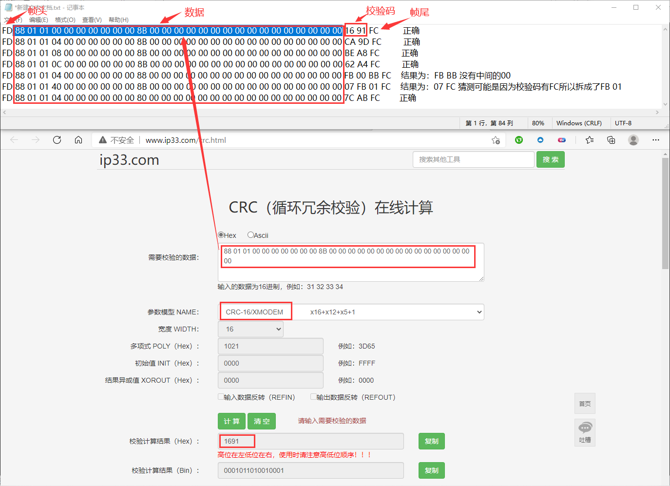

帮忙解析一下串口校验算法,看看帧尾FC的前2个是怎么算出来的,以下是单片机发出来的数据:
FD 88 01 01 00 00 00 00 00 00 00 8B 00 00 00 00 00 00 00 00 00 00 00 00 00 00 00 00 16 91 FC
FD 88 01 01 04 00 00 00 00 00 00 8B 00 00 00 00 00 00 00 00 00 00 00 00 00 00 00 00 CA 9D FC
FD 88 01 01 08 00 00 00 00 00 00 8B 00 00 00 00 00 00 00 00 00 00 00 00 00 00 00 00 BE A8 FC
FD 88 01 01 0C 00 00 00 00 00 00 8B 00 00 00 00 00 00 00 00 00 00 00 00 00 00 00 00 62 A4 FC
FD 88 01 01 04 00 00 00 00 00 00 88 00 00 00 00 00 00 00 00 00 00 00 00 00 00 00 00 FB 00 BB FC
FD 88 01 01 40 00 00 00 00 00 00 8B 00 00 00 00 00 00 00 00 00 00 00 00 00 00 00 00 07 FB 01 FC
FD 88 01 01 04 00 00 00 00 00 00 80 00 00 00 00 00 00 00 00 00 00 00 00 00 00 00 00 7C AB FC

采用的是CRC-16/XMODEM校验方式,FD为帧头,不参于校验,数据位从88开始,FC为帧尾,前两位为校验码,高位在前,低位在后

采用的是CRC-16/XMODEM校验方式,FD为帧头,不参于校验,数据位从88开始,FC为帧尾,前两位为校验码,高位在前,低位在后。可以用在线校验查看,网址为:见下图
ID:247164 发表于 2021-4-14 09:23 | 只看该作者
计算参考:【CRC笔记】CRC-16 XMODEM C语言实现  https://blog.csdn.net/u012028275/article/details/112067463

我昨天在网上查到了,也解也来了,是CRC16-CCITT算法,还是谢谢你,分给你了
