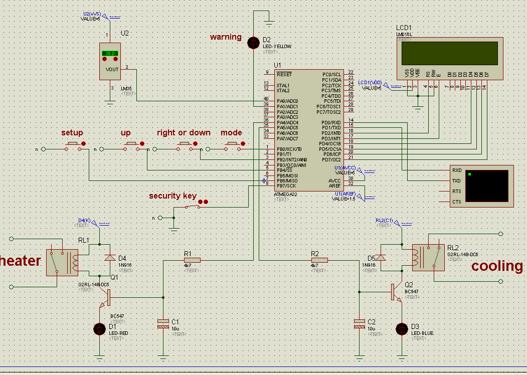

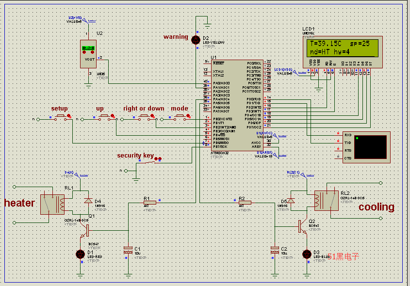

bascom-avr温控加仿真,适合单片机学习,小项目制作

  6. Dim Md1 As String * 5 , Sll1 As Byte , Slh1 As Byte , Hy1 As Byte , Alh As Eram Byte , All As Eram Byte , Alh1 As Byte , All1 As Byte
  7. Dim Hy2 As Byte , Sp2 As Byte , Md2 As String * 5 , Alh2 As Byte , All2 As Byte , V1 As Byte , Ma As Byte , Mb As Byte , Sll2 As Byte , Slh2 As Byte
  8. Config Debounce = 30
  9. Config Porta.4 = Output                                     'haeter
  10. Config Porta.5 = Output                                     'colling
  11. Config Porta.1 = Output                                     'alarm
  12. Config Pinb.7 = Input                                       'key security

  38. If F = 0 Then
  39. Cls
  40. Lcd "T=" ; V ; "C"
  41. Locate 1 , 11
  42. Lcd "sp=" ; Sp2
  43. Locate 2 , 1
  44. Lcd "md=" ; Md2 ; " " ; "hy=" ; Hy2
  45. If Porta.1 = 1 Then
  46. Locate 2 , 14
  47. Lcd "alm"
  48. End If
  49. Waitms 70
  50. End If

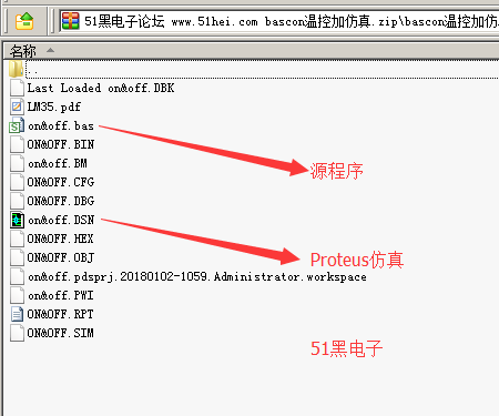

  312. …………限于本文篇幅 余下代码请从51黑下载附件…………
所有资料51hei提供下载:
bascon温控加仿真.zip (327.63 KB, 下载次数: 20)
