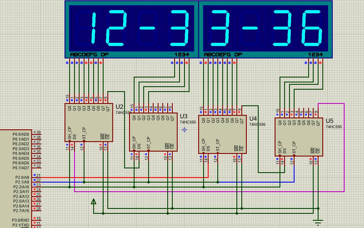

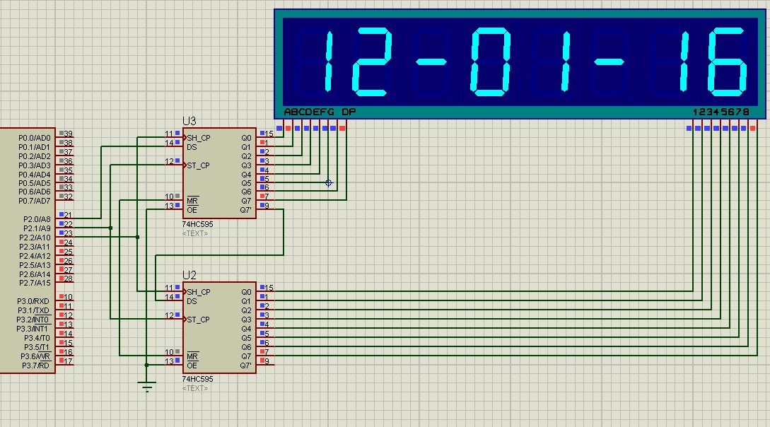

本人用的STC89C52RC芯片,4位共阳595两片模块数码管

ID:213173 发表于 2021-5-8 06:52 | 只看该作者
  1. #include <REG52.H>
  2. #define uint unsigned int
  4. sbit sda =P2^0;
  5. sbit sclk=P2^2;
  6. sbit rclk=P2^1;
  7. uchar hou=12,min,sec;
  8. uchar code table[]={0xc0,0xf9,0xa4,0xb0,0x99,0x92,0x82,0xf8,0x80,0x90,0x88,0x83,0xc6,0xa1,0x86,0x8e,0xbf,0x7f};//共阳数码管段码"0~f-."
  9. uchar code wela[]={0x01,0x02,0x04,0x08,0x10,0x20,0x40,0x80};//共阳数码管位码
  10. uchar dis_buf[]={0,0,0xbf,0,0,0xbf,0,0};//显示缓存
  11. void rck(void)
  12. {
  13.         rclk=1;
  14.         rclk=0;
  15. }
  16. void shift(uchar dat)
  17. {
  18.         uchar i;
  19.         for(i=0;i<8;i++)
  20.         {
  21.                 sda=dat&0x80;//提取最高位
  22.                 sclk=1;
  23.                 sclk=0;
  24.                 dat<<=1;
  25.         }
  26. }
  27. void DisplayScan()
  28. {
  29.         static uchar i=0;
  30.         shift(wela[i]);//送位码
  31.         shift(dis_buf[i]);//送段码
  32.         rck();//锁存
  33.         i=++i%8;//循环扫描计数
  34. }
  35. void init(void)
  36. {
  37.         TMOD=0x01;
  38.         TH0=(65536-50000)/256;
  39.         TL0=(65536-50000)%256;
  40.         TR0=1;
  41.         ET0=1;
  42.         EA=1;
  43. }
  44. void main(void)
  45. {
  46.         uchar sec1=255;
  47.         init();
  48.         while(1)
  49.         {
  50.                 if(sec1!=sec)
  51.                 {
  52.                         dis_buf[7]=table[sec%10];
  53.                         dis_buf[6]=table[sec/10];
  54.                         dis_buf[4]=table[min%10];
  55.                         dis_buf[3]=table[min/10];
  56.                         dis_buf[1]=table[hou%10];
  57.                         dis_buf[0]=table[hou/10];
  58.                         sec1=sec;
  59.                 }
  60.                 DisplayScan();
  61.         }
  62. }
  63. void time0(void) interrupt 1
  64. {
  65.         static uchar tcount;
  66.         TH0=(65536-50000)/256;
  67.         TL0=(65536-50000)%256;
  68.         tcount++;
  69.         if(tcount==20)
  70.         {
  71.                 tcount=0;
  72.                 sec++;
  73.                 if(sec==60)
  74.                 {
  75.                         sec=0;
  76.                         min++;
  77.                         if(min==60)
  78.                         {
  79.                                 min=0;
  80.                                 hou++;
  81.                                 if(hou==24)
  82.                                 {
  83.                                         hou=0;
  84.                                 }
  85.                         }
  86.                 }
  87.         }
  88. }

4位共阳595两片模块数码管
  4. sbit sda =P2^0;
  5. sbit sclk=P2^2;
  6. sbit rclk=P2^1;
  7. uchar hou=12,min=32,sec=40;
  11. void rck(void)
  12. {
  13.         rclk=1;
  14.         rclk=0;
  15. }
  17. {
  18.         uchar i;
  20.         {
  22.                 sclk=1;
  23.                 sclk=0;
  24.                 dat<<=1;
  25.         }
  26. }
  28. {
  32.         shift(wela[i]);//送位码
  33.         shift(dis_buf[i+4]);//送段码
  34.         rck();//锁存
  35.         i=++i%4;//循环扫描计数
  36. }
  37. void init(void)
  38. {
  39.         TMOD=0x01;
  40.         TH0=(65536-50000)/256;
  41.         TL0=(65536-50000)%256;
  42.         TR0=1;
  43.         ET0=1;
  44.         EA=1;
  45. }
  46. void main(void)
  47. {
  48.         uchar sec1=255;
  49.         init();
  50.         while(1)
  51.         {
  52.                 if(sec1!=sec)
  53.                 {
  54.                         dis_buf[7]=table[sec%10];
  55.                         dis_buf[6]=table[sec/10];
  56.                         dis_buf[4]=table[min%10];
  57.                         dis_buf[3]=table[min/10];
  58.                         dis_buf[1]=table[hou%10];
  59.                         dis_buf[0]=table[hou/10];
  60.                         sec1=sec;
  61.                 }
  62.                 DisplayScan();
  63.         }
  64. }
  65. void time0(void) interrupt 1
  66. {
  67.         static uchar tcount;
  68.         TH0=(65536-50000)/256;
  69.         TL0=(65536-50000)%256;
  70.         tcount++;
  71.         if(tcount==20)
  72.         {
  73.                 tcount=0;
  74.                 sec++;
  75.                 if(sec==60)
  76.                 {
  77.                         sec=0;
  78.                         min++;
  79.                         if(min==60)
  80.                         {
  81.                                 min=0;
  82.                                 hou++;
  83.                                 if(hou==24)
  84.                                 {
  85.                                         hou=0;
  86.                                 }
  87.                         }
  88.                 }
  89.         }
  90. }
