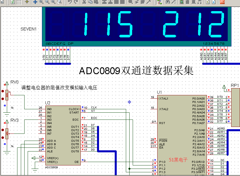

基于AT89C51单片机的ADC0809两路数据采集代码Proteus仿真
调整电位器的阻值改变模拟输入电压
完成对ADC0809(模数转换器)的两个通道的输入模拟量进行转换,两个通道的结果显示各占3位,同时显示在8位数码管上(有效显示位数为6位)。两个通道的采集模拟输入电压的大小由两个滑动电位器来调节,后续也可以换成温度传感器,光线传感器,红外传感器等各种传感器,可构成测量不同变量的检测电路。
  1. /******************************************************************************/
  2. #include <reg51.h>
  4. sbit dula=P2^0;
  5. sbit wela=P2^1;
  6. sbit CLK=P1^3;
  7. sbit ST=P1^2;
  8. sbit OE=P1^0;
  9. sbit EOC=P1^1;
  10. sbit wei1=P2^1;
  11. sbit wei2=P2^2;
  12. sbit wei3=P2^3;
  13. sbit wei4=P2^5;
  14. sbit wei5=P2^6;
  15. sbit wei6=P2^7;
  16. uchar code dulatab[]={0x3f,0x06,0x5b,0x4f,0x66,
  17.                                           0x6d,0x7d,0x07,0x7f,0x6f,0x40}; //数字编码0-9
  18. uchar code welatab[]={0xfe,0xfd,0xfb,0xf7,0xef,0xdf,0xbf,0x7f};//位控制字
  19. uchar count;
  20. void delay(uchar time)         //延时
  21. {
  22.         uchar i,j;
  23.         for(i=0;i<time;i++)
  24.         {
  25.                 for(j=0;j<110;j++)
  26.                 ;
  27.         }
  28. }
  29. /*********系统初始化***********/
  30. void init()
  31. {
  32. P2=0xff;
  33. EA = 1;                     //开总中断
  34. TMOD = 0x02;                //设定定时器T0工作方式
  35. TH0=216;                    //利用T0中断产生CLK信号
  36. TL0=216;                                         //定时40us频率25K
  37. TR0=1;                      //启动定时器T0
  38. ET0=1;
  39. ST=0;
  40. OE=0;
  41. P1=0x30;
  42. }
  43. void write1(uchar num)
  44. {
  45.         uchar i,j,k;
  46.         k=num/100;
  47.         j=num%100/10;
  48.         i=num%10;
  49.         P2=0xff;
  50.         P0=dulatab[k];
  51.         wei4=0;
  52.         delay(4);
  53.
  54.         P2=0xff;
  55.         P0=dulatab[j];
  56.         wei5=0;
  57.         delay(4);
  58.
  59.         P2=0xff;
  60.         P0=dulatab[i];
  61.         wei6=0;
  62.         delay(4);
  63. }
  64. void write0(uchar num)
  65. {
  66.         uchar i,j,k;
  67.         k=num/100;
  68.         j=num%100/10;
  69.         i=num%10;
  70.         P2=0xff;
  71.         P0=dulatab[k];
  72.         wei1=0;
  73.         delay(4);
  74.
  75.         P2=0xff;
  76.         P0=dulatab[j];
  77.         wei2=0;
  78.         delay(4);
  79.
  80.         P2=0xff;
  81.         P0=dulatab[i];
  82.         wei3=0;
  83.         delay(4);
  84. }
  85. uchar adin0()
  86. {
  87.         uchar value;
  88.         OE=0;
  89.         EOC=1;
  90.         ST=0;
  91.         P1&=0x8f;
  92.         P1|=0x30;
  93.         delay(10);
  94.         ST=1;
  95.         delay(10);
  96.         ST=0;
  97.         while(!EOC);
  98. //        EOC=0;
  99.         delay(10);
  100.         OE=1;
  101.         delay(1);
  102.         value=P3;
  103.         OE=0;
  104.         return value;
  105. }
  106. uchar adin1()
  107. {
  108.         uchar value;
  109.         OE=0;
  110.         EOC=1;
  111.         ST=0;
  112.         P1&=0x8f;
  113.         P1|=0x00;
  114.         delay(10);
  115.         ST=1;
  116.         delay(10);
  117.         ST=0;
  118.         while(!EOC);
  119. //        EOC=0;
  120.         delay(10);
  121.         OE=1;
  122.         delay(1);
  123.         value=P3;
  124.         OE=0;
  125.         return value;
  126. }
  127. void main()
  128. {
  129.         uchar in0,in1;
  130.         init();
  131.         while(1)
  132.         {
  133.                 in0=adin0();
  134.                 write0(in0);
  135.                 in1=adin1();
  136.                 write1(in1);
  137.         }
  138. }
  139. void timer0(void) interrupt 1
  140. {
  141. CLK=~CLK;
  142. }
