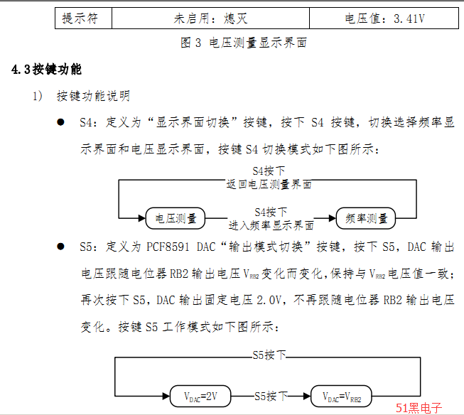

蓝桥杯单片机第10届省赛源程序
  1. #include <STC15F2K60S2.H>
  2. #include <intrins.h>
  3. #include "iic.h"
  5. #define uint unsigned int
  6. void Delay1ms();
  7. uchar code duanxuan[]={0XC0,0XF9,0XA4,0XB0,0X99,0X92,0X82,0XF8,0X80,0X90,0XBF,0XFF,0XC6,0x8e,0xc1};//0,1,2,3,4,5,6,7,8,9,-,空,c,f,u
  8. uchar code duanxuan1[]={0x40,0x79,0x24,0x30,0x19,0x12,0x02,0x78,0x00,0x10,0x8e,0xc1};  //0,1,2,3,4,5,6,7,8,9,f,u
  9. bit dianya_biao=1,pinlv_biao=0,DI,shuma_biao=0,led_biao=0,dianya_moshi=0;
  10. uint count_ya=0,count_pin=0,count_yashua=0,count_pinshua=0,dat_f,dat_u,dat_u1,flag,DAC_jiemian=0,LED_jiemian=0,zhujiemian=0,shuma_jiemian=0,hao=2;
  11. void led_xianshi();
  12. void dac();
  13. void keyscan4();
  14. void all_chushihua();
  15. void Delay5ms();
  16. void dingshiqi_chushihua();
  17. void hc138(uchar n);
  18. void display(uchar pos,uchar dat);
  19. void shuma_xianshi();
