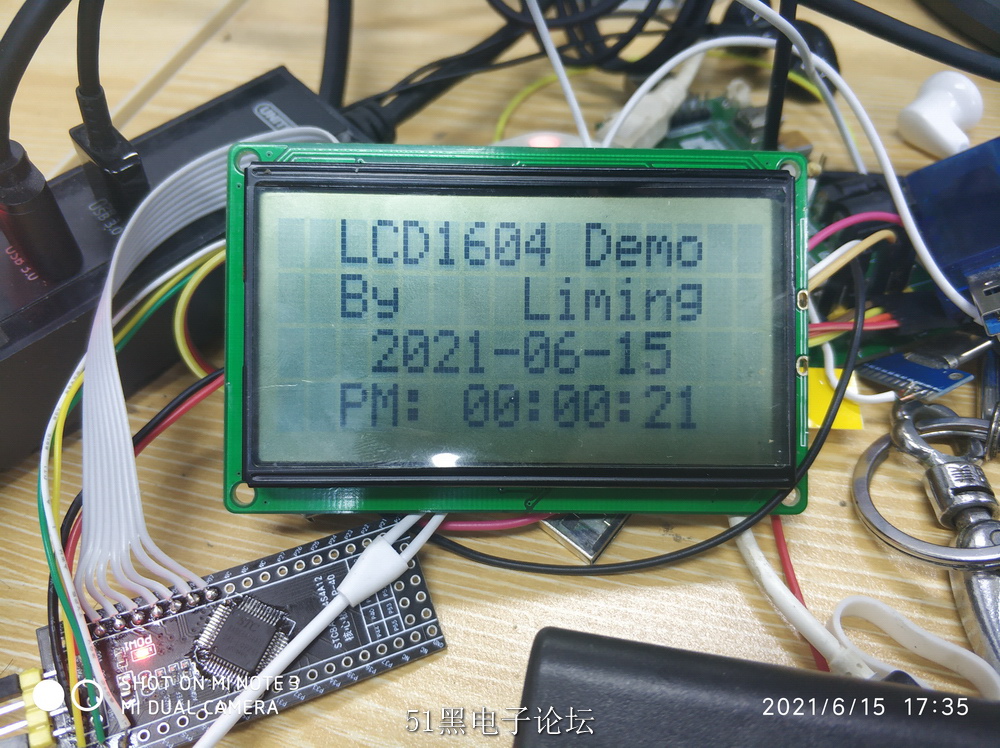

单片机驱动LCM1604四行液晶例程

  17. /* Private functions ---------------------------------------------------------*/
  18. unsigned int time_ms;
  19. unsigned char  seg[]={
  20. "  LCD1604 Demo  "
  21. "  By    Liming  "
  22. "   2021-06-15   "
  23. "  PM: --:--:--  "
  24. };

  89.   LCD_EN = 0;
  90. }
  91. void initial(void){
  92.   LCD1604_WriteCmd(0x38);
  93.   LCD1604_WriteCmd(0x01);
  94.   LCD1604_WriteCmd(0x06);
  95.   LCD1604_WriteCmd(0x0c);
  96. }
  97.
  98. void main(void){
  99.   unsigned char data_index;
  100.   unsigned char i;
  101.
  102.   TIM0_Init();  //SysTick 1ms
  103.   initial();        //初始化LCD
  104.   while(1){
  105.     if(task1s==0)
  106.     {
  107.       task1s = 1000;sec++;
  108.       if(sec>=60){
  109.         sec = 0;min++;
  110.         if(min>=60){
  111.           min = 0;hour++;
  112.           if(hour>=12)hour = 0;
  113.         }
  114.       }
  115.       seg[54] = (hour/10)+'0';
  116.       seg[55] = (hour%10)+'0';
  117.       seg[57] = (min/10)+'0';
  118.       seg[58] = (min%10)+'0';
  119.       seg[60] = (sec/10)+'0';
  120.       seg[61] = (sec%10)+'0';
  121.
  122.       data_index = 0;
  123.       LCD1604_WriteCmd(0x80);//第一行
  124.       while(data_index<=15){LCD1604_WriteDat(seg[data_index]);data_index++;}
  125.       LCD1604_WriteCmd(0xc0);//第二行
  126.       while(data_index<=31){LCD1604_WriteDat(seg[data_index]);data_index++;}
  127.       LCD1604_WriteCmd(0x90);//第三行
  128.       while(data_index<=47){LCD1604_WriteDat(seg[data_index]);data_index++;}
  129.       LCD1604_WriteCmd(0xd0);//第四行
  130.       while(data_index<=63){LCD1604_WriteDat(seg[data_index]);data_index++;}
  131.     }
