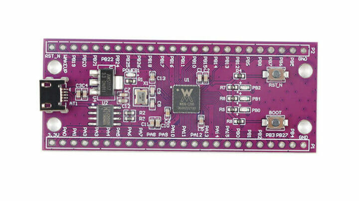

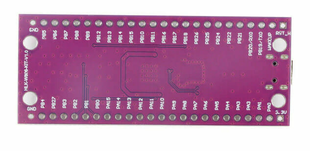

HLK-W806 开发板
参数
  • MCU – WinnerMicro W806 32-bit XT804 MCU
    • 240 MHz
    • 1MB Flash
    • 288KB RAM
    • FPU, DSP, crtypto engine
  • 2x24排针
  • 1x SDIO host with support for SDIO 2.0, SDHC, MMC 4.2
  • 1x SDIO device up to 200 Mbps
  • Up to 6x UART, 1x I2C
  • 1x SPI slave up to 50 MHz, 1x master/slave SPI
  • LCD controller with support for 4×32 interface
  • 1x I2S
  • Up to 4x ADC (16-bit, 1KHz sampling rate)
  • Up to 44x GPIOs, 5x PWM, PWM最高到160KHz, 分辨率比较低只有8bit
  • Up to 15 touch sensors
  • ISO/IEC 7816 smart card interface
  • Reset, Wakeup, 3.3V, and GND signals
  • Debugging – CH340 via micro USB port
  • Misc – Reset and Boot buttons
  • Power Supply – 5V via micro USB port
  • 尺寸65 x 26 mm
