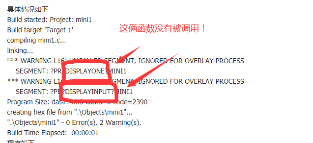

各位大佬,请帮忙看一下为什么我这个keil密码锁程序会出现未调用的
具体情况如下
Build started: Project: mini1
Build target 'Target 1'
compiling mini1.c...
linking...
*** WARNING L16: UNCALLED SEGMENT, IGNORED FOR OVERLAY PROCESS
    SEGMENT: ?PR?DISPLAYONE?MINI1
    SEGMENT: ?PR?DISPLAYINPUT?MINI1
Program Size: data=46.5 xdata=0 code=2390
creating hex file from ".\Objects\mini1"...
".\Objects\mini1" - 0 Error(s), 2 Warning(s).
Build Time Elapsed:  00:00:01

忽略它,没用到没关系的。
