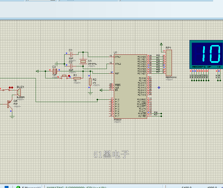

单片机定时器仿真+程序 倒计时,时间到了蜂鸣器发声
秒倒计时,时间到了蜂鸣器发声
#include <reg51.h>
unsigned char count=0;
sbit LED_B1=P3^6;
sbit LED_A1=P3^7;
sbit fmq=P1^0;
unsigned char counter;
unsigned char NSF=10;
typedef unsigned int u16;          //对数据类型进行声明定义
typedef unsigned char u8;
sbit k1=P3^1;
sbit k2=P3^0;
sbit beep=P1^0;
u8 start=0;
void delayms(unsigned int xms);
void Init(void)
        TMOD=0x01;
        TH0=(65536-10000)/256;
        TL0=(65536-10000)%256;
        TR0=1;
        ET0=1;
EA=1;
void timer0(void) interrupt 1
        TMOD=0x01;
        TH0=(65536-50000)/256;
        TL0=(65536-50000)%256;
        TR0=1;
        ET0=1;
        EA=1;
           count++;
        if(count>19)
            count=0;
         NSF--;
                unsigned int i,j;
                for(i=xms;i>0;i--)
                        for(j=110;j>0;j--);
unsigned char table[]={0x3,0xcf,0x2a,0x4a,0xc6,0x52,0x12,0xcb,0x2,0x42};
void display1(unsigned char num1,unsigned char num2)
                LED_A1=1;
                P0=table[num1];
                delayms(10);
                LED_A1=0;
                LED_B1=1;
                P0=table[num2];
                delayms(10);
                LED_B1=0;
void main()
          EA=1;          beep=1;
    Init();
                    while(NSF!=0)
                   display1(NSF/10,NSF%10);
                   delayms(10);
Keil代码与Proteus仿真下载: 30秒倒计时.zip (81.06 KB, 下载次数: 116)
