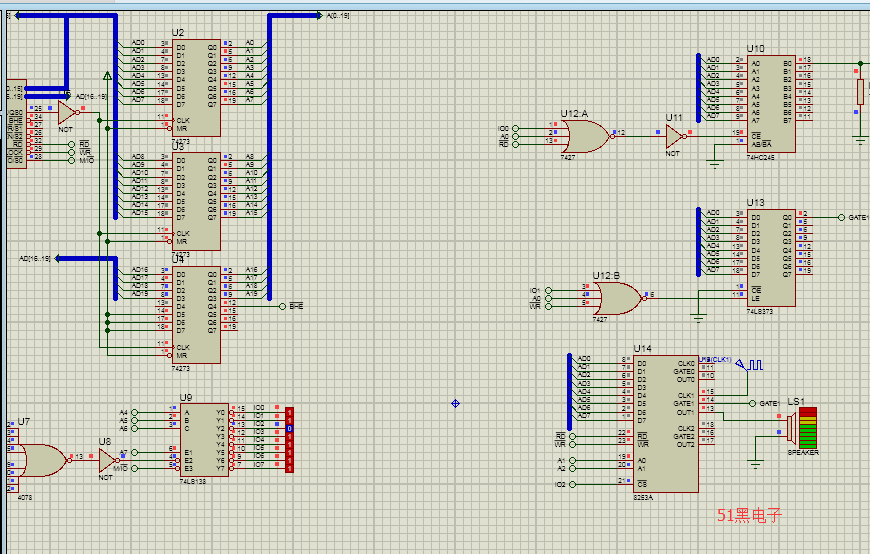

电子发声程序 8086播放两只老虎Proteus仿真图

                CLK            DW 34DDH,12H

START:        MOV AX,DATA
                MOV DS,AX
                MOV AL,76H
                MOV        DX,TCONTR0
                OUT DX,AL

REPEAT1:MOV SI,OFFSET F_LIST
                MOV DI,OFFSET T_LIST
AGAIN:        MOV BX,[SI]
                MOV AX,CLK
                MOV DX,CLK+2
                DIV BX
                MOV DX,TCON1
                OUT DX,AL
                MOV AL,AH
                OUT DX,AL
                MOV CX,[DI]
LP1:        CALL DELAY
                LOOP LP1
