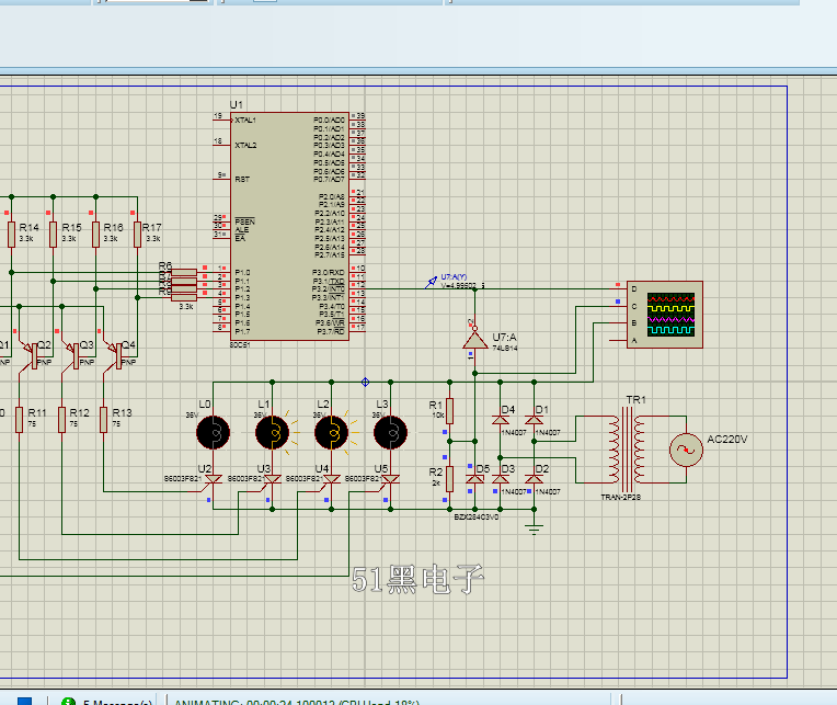

单片机中断控制AC220V可控硅闪灯源程序与Proteus仿真原理图
#include<reg51.h>
unsigned char delay_par=0x8;                                  //闪灯次数初值
unsigned char light_code=0xf7;                                //闪灯位置初值
void delay(void){                                                 //可控硅触发维持时间
          unsigned char i=5;
          if(i>=0)  i--;
void main(){
          TCON=0x01;                                                           //中断设置为下降沿触发
          EA=1;
          EX0=1;                                                                          //开中断
          while(1);
void INT0_srv(void) interrupt 0 {
        P1=light_code;                                                        //触发可控硅(闪灯开始)
        delay();                                                                //延时20us
        P1=0xff;                                                                //关断触发
        delay_par--;                                                        //统计闪灯次数
        if(delay_par==0){                                                //切换闪灯位置
                switch(light_code){
                        case 0xf7:         light_code=0xfb;    break;
                        case 0xfb:         light_code=0xfd;         break;
                        case 0xfd:         light_code=0xfe;         break;
                        case 0xfe:         light_code=0xf7;         break;
                        default:          break;
                delay_par=0x8;                                                 //重置闪灯次数

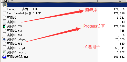

Keil代码与Proteus仿真下载: 闪灯.7z (67.66 KB, 下载次数: 41)
