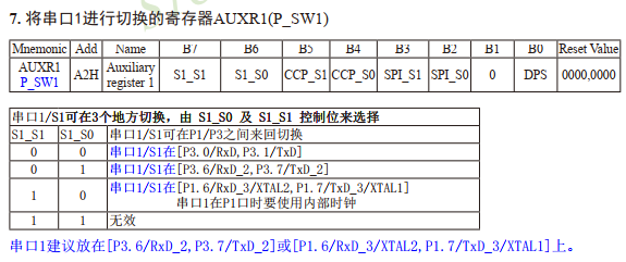

求大神们指点15单片机串口怎么切换到p3.6 p3.7上?
如题
ID:161164 发表于 2022-7-25 14:41 | 只看该作者
如图

void Uart1_P37(void)
        ACC = P_SW1;
  ACC &= ~(S1_S0 | S1_S1);    //S1_S0=1 S1_S1=0
  ACC |= S1_S0;               //(P3.6/RxD_2, P3.7/TxD_2)
  P_SW1 = ACC;
void Uart1_P31(void)
        ACC = P_SW1;
  ACC &= ~(S1_S0 | S1_S1);    //S1_S0=0 S1_S1=0
  P_SW1 = ACC;                //(P3.0/RxD, P3.1/TxD)

P_SW1 &=0xbf;  //S1_S0=0
P_SW1 |=0x80;  //S1_S1=1
