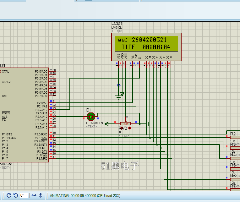

单片机定时器LCD1602显示简易电子钟代码Proteus仿真图
这是一个简单的电子时钟设计,利用LCD1602显示,均为原创,请大家指正
  1. #include<reg51.h>
  2. //#include<lcd1602.h>
  4. #define uint unsigned int
  5. uchar int_time;
  6. uchar second;
  7. uchar minute;
  8. uchar hour;
  9. void write_data(uchar date);
  10. void write_com(uchar com);
  11. void init1602();
  12. void write_string(uchar *pp, uint n);
  13. void write_sfm(uchar add,uchar date);
  14. uchar code date[]="wwj 2604200321";
  15. uchar code time[]=" TIME  23:59:55 ";
  16. uchar second=55,minute=59,hour=23;
  17. void clock_init(){
  18.         uchar i,j;
  19.         for(i=0;i<16;i++){
  20.                 write_data(date[i]);
  21.         }
  22.         write_com(0x80+0x40);
  23.         for(j=0;j<16;j++){
  24.                 write_data(time[j]);
  25.         }
  26. }
  27. void clock_write(uint s, uint m, uint h){
  28.         write_sfm(0x47,h);
  29.         write_sfm(0x4a,m);
  30.         write_sfm(0x4d,s);
  31. }
  32. void main(){
  33.         init1602();
  34.         clock_init();
  35.         TMOD=0x01;
  36.         EA=1;
  37.         ET0=1;
  38.         TH0=(65536-46483)/256;
  39.         TL0=(65536- 46483)%256;
  40.         TR0=1;
  41.         int_time=0;
  42.         second=55;
  43.         minute=59;
  44.         hour=23;
  45.         while(1){
  46.                 clock_write(second,minute,hour);
  47.         }
  48. }
  49. void T0_interserve(void) interrupt 1 using 1{
  50.         int_time++;
  51.         if(int_time==20){
  52.                 int_time=0;
  53.                 second++;
  54.         }
  55.         if(second==60){
  56.                 second=0;
  57.                 minute++;
  58.         }
  59.         if(minute==60){
  60.                 minute=0;
  61.                 hour ++;
  62.         }
  63.         if(hour==24){
  64.                 hour=0;
  65.         }
  66.         TH0=(65536-46083)/256;
  67.         TL0=(65536- 46083)%256;
  68. }
  69. //#ifndef LCD_CHAR_1602_2011_5_9
  70. #define LCD_CHAR_1602_2011_5_9
  71. #define uchar unsigned char
  72. #define uint unsigned int
  73. sbit Icdrs = P2^0;
  74. sbit Icdrw= P2^1;
  75. sbit Icden= P2^2;
  76. void delay(uint z){
  77.         uint x,y;
  78.         for(x=z;x>0;x--){
  79.                 for(y=110;y>0;y--);
  80.         }
  81. }
  82. void write_com(uchar com){
  83.         Icdrw=0;
  84.         Icdrs=0;
  85.         P3=com;
  86.         delay(5);
  87.         Icden=1;
  88.         delay(5);
  89.         Icden=0;
  90. }
  91. void write_data(uchar date){
  92.         Icdrw=0;
  93.         Icdrs=1;
  94.         P3=date;
  95.         delay(5);
  96.         Icden=1;
  97.         delay(5);
  98.         Icden=0;
  99. }
  100. void init1602(){
  101.         Icdrw=0;
  102.         Icden=0;
  103.         write_com(0x3C);
  104.         write_com(0x0c);
  105.         write_com(0x06);
  106.         write_com(0x01);
  107.         write_com(0x80);
  108. }
  109. void write_string(uchar *pp, uint n){
  110.         int i;
  111.         for(i=0;i<n;i++){
  112.                 write_data(pp[i]);
  113.         }
  114. }
  115. void write_sfm(uchar add,uchar date){
  116.         uchar shi,ge;
  117.         shi=date/10;
  118.         ge=date%10;
  119.         write_com(0x80+add);
  120.         write_data(0x30+shi);
  121.         write_data(0x30+ge);
  122. }
  123. //#endif
Keil代码与Proteus8.13仿真下载:
LCD.7z (35.31 KB, 下载次数: 57)
