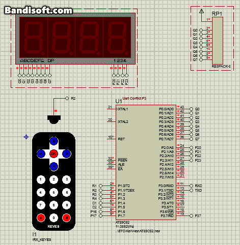

89C52单片机定时器2捕获模式解码红外遥控程序与Proteus仿真图
ID:161164 发表于 2022-12-22 16:00 | 显示全部楼层 |阅读模式
以下部分为单片机代码:
  1. bit IR_Done = 0;
  2. union {
  3.         u8 THTL[2];
  4.         u16 TIME;
  5. }U_THTL[33];
  6. void Timer2Init(void)
  7. {
  8.         EXF2 = 0;
  9.         EXEN2 = 1;
  10.         CP_RL2 = 1;
  11. }
  12. void timer2_int() interrupt 5
  13. {
  14.         static u8 i = 0;
  15.         if(TF2)
  16.     {
  17.                 TF2 = 0;
  18.                 TR2 = 0;
  19.         }
  20.         if(EXF2)
  21.     {
  22.                 EXF2 = 0;
  23.                 if(!TR2)
  24.                 {
  25.                         TL2 = 0;
  26.                         TH2 = 0;
  27.                         TR2 = 1;
  28.                         i = 0;
  29.                 }else{
  30.                         U_THTL[i].THTL[0] = RCAP2H;
  31.                         U_THTL[i].THTL[1] = RCAP2L;
  32.                         TL2 = 0;
  33.                         TH2 = 0;
  34.                         if(++i>=33)
  35.                         {
  36.                                 i=0;
  37.                                 IR_Done = 1;
  38.                         }
  39.                 }
  40.         }
  41. }
  42. void main()
  43. {
  44.         Timer1Init();
  45.         Timer2Init();
  46.         ET1 = 1;
  47.         ET2 = 1;
  48.         EA = 1;
  49.     while (1)
  50.     {
  51.         if(IR_Done)
  52.                 {
  53.                         u8 i;
  54.                         u16 Temp[2];
  55.                         IR_Done = 0;
  56.                         for(i=1;i<33;i++)
  57.                         {
  58.                                 Temp[(i-1)/16]<<=1;
  59.                                 if(U_THTL[i].TIME>0x0648)
  60.                                 {
  61.                                         Temp[(i-1)/16] |= 0x0001;
  62.                                 }
  63.                         }
  64.                         Disp_Buff[0] = Temp[1]>>12 & 0x0F;
  65.                         Disp_Buff[1] = Temp[1]>>8 & 0x0F;
  66.                         Disp_Buff[2] = Temp[1]>>4 & 0x0F;
  67.                         Disp_Buff[3] = Temp[1] & 0x0F;
  68.                         DispEN = 1;
  69.                 }
  70.     }
  71. }

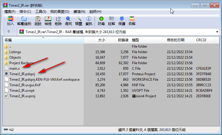

Timer2_IR.rar (121.11 KB, 下载次数: 100)
ID:648281 发表于 2022-12-22 21:34 | 显示全部楼层
好资料,想问下,proteus是用什么版本打开仿真
ID:161164 发表于 2022-12-23 08:48 | 显示全部楼层
我用的是8.13
