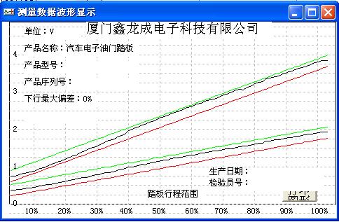

新的工装已经完成,利用新的工装,重新修改了软件,基本上完成了软件的调试,现将之前一直无法完成的内容总结下:
1.之前的实际数据量与图形标识的百分比对不上号,现将百分比按实际数据量进行划分,就可以一一一对应;
2.增加了超过误差要求的数据数量的统计,如果错误数据超过设订值,提示报警(声音和文本双重提示);
3.增加了四条偏差范围标准线,在必要的时候可以同时打印标准线;
4.打印功能可以实现打印及图像保存
现将设计的效果图及代码保存如下,必要的时候可以调出来参考:
波形代码:
Private Declare Function sndPlaySound Lib "winmm.dll" Alias "sndPlaySoundA" (ByVal lpszSoundName As String, ByVal uFlags As Long) As Long
Private Sub Command4_Click()
Dim plays As Long
plays = sndPlaySound("D:\汽车电子油门检测软件\sy\单击.wav", &H0) '声音
Command4.Visible = False
Me.PrintForm '实现打印功能
Exit Sub
End Sub
Private Sub Text12_Click()
Dim plays As Long
Dim myArray(6) As String '显示数据数组
Dim MyColor(6) As Long      '颜色控制数组
Dim MyCaption(150) As String 'X轴显示数组
Dim MyLegend(2) As String
Dim I As Integer
Dim K As Integer
K = Int(frmMain.Text11.Text)
For I = 0 To K 'K为实际数据量
If I = Int(K / 10) Then
MyCaption(I) = "10%"
ElseIf I = Int((K / 10) * 2) Then 'INT为取整,只有取整才可以显示百分比
MyCaption(I) = "20%"
ElseIf I = Int((K / 10) * 3) Then
MyCaption(I) = "30%"
ElseIf I = Int((K / 10) * 4) Then
MyCaption(I) = "40%"
ElseIf I = Int((K / 10) * 5) Then
MyCaption(I) = "50%"
ElseIf I = Int((K / 10) * 6) Then
MyCaption(I) = "60%"
ElseIf I = Int((K / 10) * 7) Then
MyCaption(I) = "70%"
ElseIf I = Int((K / 10) * 8) Then
MyCaption(I) = "80%"
ElseIf I = Int((K / 10) * 9) Then
MyCaption(I) = "90%"
ElseIf I = K Then
MyCaption(I) = "100%"
End If
Next I
'Me.ForeColor = vbRed
'myArray(0) = Text1.Text
'MyColor(0) = vbRed
myArray(1) = Text2.Text
MyColor(1) = vbBlack 'vbBlue
myArray(2) = Text3.Text
MyColor(2) = vbBlack 'vbGreen
myArray(3) = Text15.Text
MyColor(3) = vbGreen 'vbBlack
myArray(4) = Text19.Text
MyColor(4) = vbRed
myArray(5) = Text20.Text
MyColor(5) = vbGreen 'vbBlack
myArray(6) = Text21.Text
MyColor(6) = vbRed
Chart1.MaxValue = 500   'Y轴最大值
Chart1.MinValue = 0      'Y轴最小值
Chart1.DrawGraph myArray, MyColor, MyCaption '显示图形
End Sub
