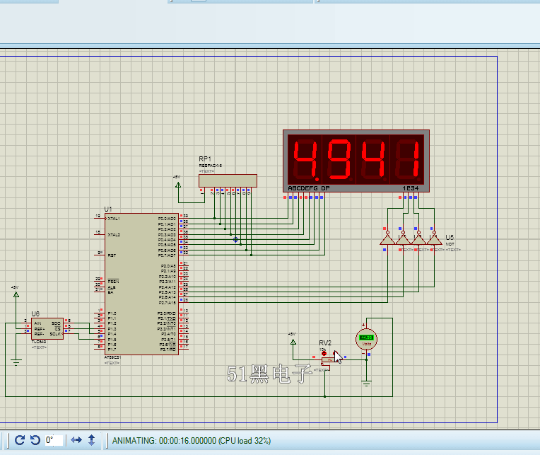

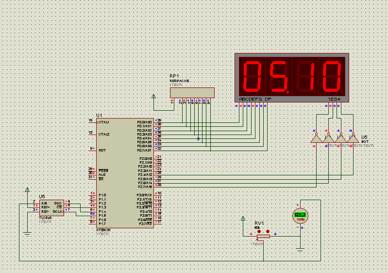

TLC549转换器电路Proteus仿真原理图如下:
  1. /*
  2. *软 件 标 题:TLC549 AD采样子程序
  3. *软 件 说 明:从TLC549读取采样值
  4. *_________________________________________
  5. *
  6. */
  7. #include <REGX51.H>//头文件
  8. #include "intrins.h"
  9. #define    Wait1us        _nop_();
  10. #define    Wait2us        {_nop_();_nop_();}
  11. #define    Wait4us        {Wait2us;Wait2us;}
  12. #define    Wait8us        {Wait4us;Wait4us;}
  13. #define    Wait10us      {Wait8us;Wait2us;}
  14. #define    Wait30us      {Wait10us;Wait8us;Wait4us;Wait2us;}
  15. /************定义接口总线**************/
  16. sbit Clock = P1 ^ 5; //时钟口线
  17. sbit DataOut = P1 ^ 4; //数据输出口线
  18. sbit ChipSelect = P1 ^ 3; //片选口线
  19. /************接口总线定义结束**********/
  20. /*********函数名称:ADCSelChannel********
  21. *
  22. *功能:转换指定通道的模拟量为数字量
  23. *
  24. *说明:
  25. *
  26. *位置:1
  27. *
  28. ****************************************/
  29. unsigned char ADCSelChannel(void)
  30. {
  31.       unsigned char ConvertValue = 0;
  32.       unsigned char i;
  33.       ChipSelect = 1; //芯片复位
  34.       ChipSelect = 0;
  35.       ChipSelect = 1;
  36.       Clock = 0;
  37.       Wait4us;
  38.       ChipSelect = 0; //芯片起始
  39.       Wait4us; //等待延时
  40.       for (i = 0; i < 8; i ++) //输入采样转换时钟
  41.       {
  42.             Clock = 1;
  43.             Clock = 0;
  44.       }
  45.       ChipSelect = 1; //开始转换
  46.       Wait10us; //等待转换结束
  47.       ChipSelect = 0; //读取转换结果
  48.       Wait4us;
  49.       for (i = 0; i < 8; i ++) //
  50.       {
  51.             Clock = 1;
  52.             ConvertValue <<= 1;
  53.             if (DataOut)
  54.             {
  55.                    ConvertValue = 0x1;
  56.             }
  57.             Clock = 0;
  58.       }
  59.       ChipSelect = 1;
  60.       return (ConvertValue); //返回转换结果
  61. }
  1. #include <REGX51.H>//头文件
  2. #include "intrins.h"//空操作文件
  3. #include<stdio.h>
  4. #include<stdlib.h>
  5. #define  uchar unsigned char//宏定义char
  6. #define  uint          unsigned int//宏定义int
  7. void delay(long i){while(i--);}
  8. uchar code tb[10] = {0xc0,0xf9,0xa4,0xb0,0x99,0x92,0x82,0xf8,0x80,0x90};//数码管段选
  9. uchar code seg_bit_scan[]={0xef,0xdf,0xbf,0x7f}; //各个数码管对应的位选数据
  10. sbit data_temp=P1^4;//数据线(读出数据)
  11. sbit cs=P1^3;//片选
  12. sbit sclk=P1^5;//io口时钟
  13. uint j;        uchar qian,bai,shi,ge;
  14. void chuli(uint num)          //显示程序
  15. {
  16.
  17.   qian=num/1000%10;              //千,百,十,个处理
  18.   bai=num/100%10;
  19.   shi=num/10%10;
  20.   ge=num%10;
  21.   }
  22. uint ad_549()                    //TLC549处理
  23. {
  24.   uchar i;
  25.   uint data_ad=0;
  26.   cs=1;//先拉高电平 //初始化,启动
  27.   sclk=0;//clk拉低电平
  28.   cs=0;//cs拉低电平
  29.   _nop_();//空操作 5微妙
  30.
