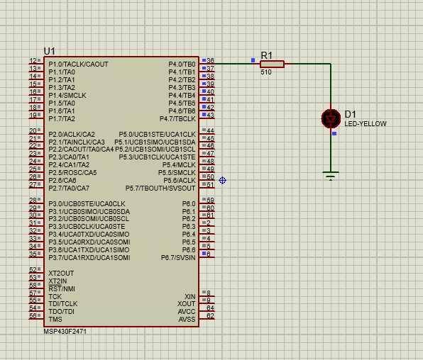

msp430f2741单片机仿真点灯
代码:
  1. #include "io430.h"
  2. int main( void )
  3. {
  4.   unsigned int i;
  5.   // Stop watchdog timer to prevent time out reset
  6.   WDTCTL = WDTPW + WDTHOLD;
  7.   P4SEL=0;
  8.   P4DIR=0XFF;
  9.   P4OUT=0X00;
  10.   while(1)
  11.   {
  12.     P4OUT^=0X01;
  13.     for(i=0;i<60000;i++);
  14.   }
  15.   return 0;
  16. }
仿真效果图
