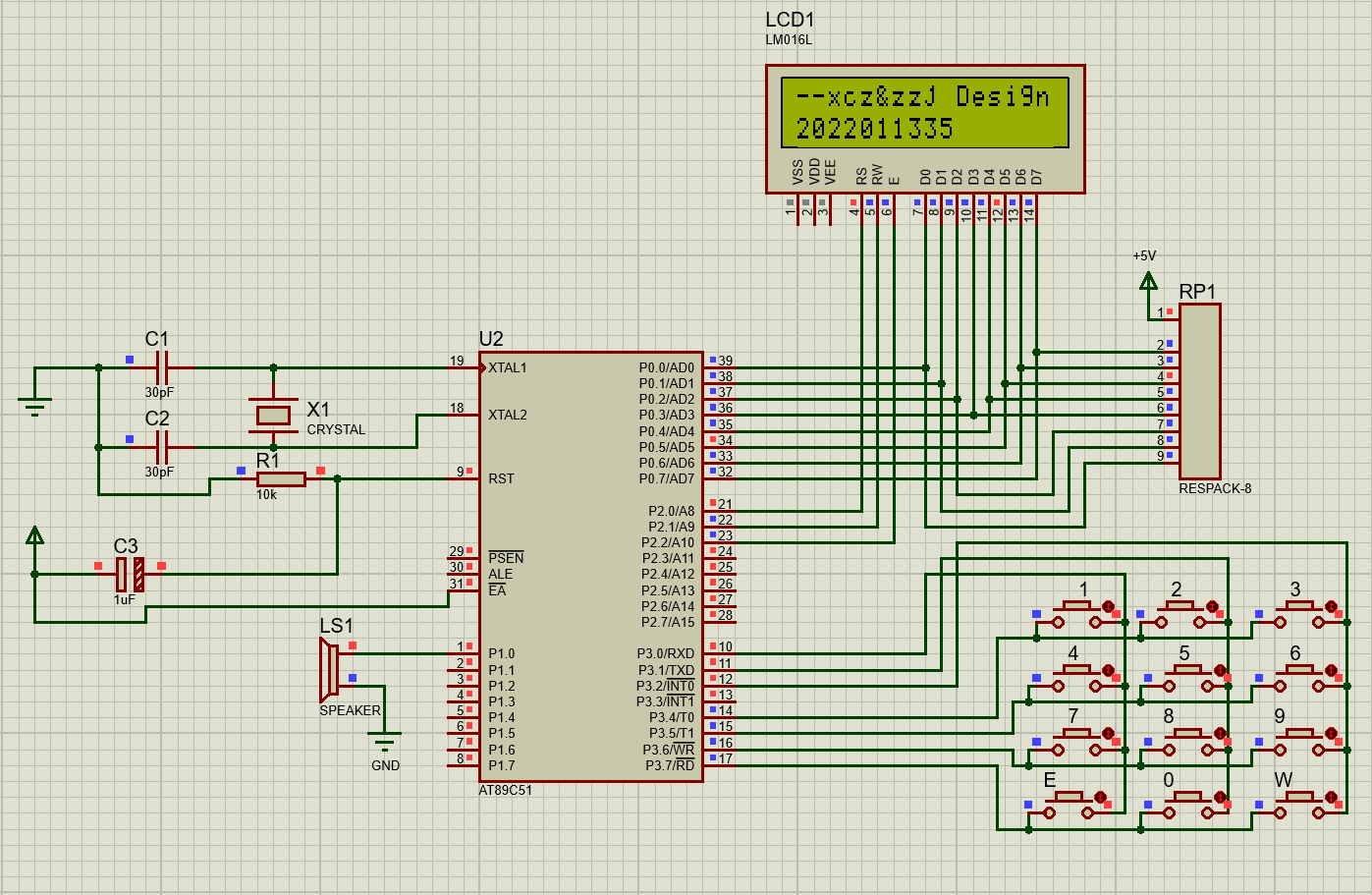

电话拨号模拟代码 单片机设计
  1. #include <reg51.h>
  2. #include <intrins.h>
  4. #define uint unsigned int
  5. #define DelayNOPx() {_nop_();_nop_();_nop_();_nop_();}
  6.   sbit  BEEP =    P1^0;
  7.   sbit  RS = P2^0;
  8.   sbit  RW = P2^1;
  9.   sbit  E = P2^2;
  10.   void DelayMS (uint ms);
  11.   bit    LCD_Busy ();
  12.   void    LCD_Pos (uchar);
  13.   void    LCD_Wcmd (uchar);
  14.   void    LCD_Wdat (uchar);
  15.   char code Title_Text[] = {"--xcz&zzj Design --"};
  16.   uchar code Key_Table[]={'1','2','3','4','5','6','7','8','9','*','0','#'};
  17.   uchar Dial_Code_Str[] = {"              "};
  18.   uchar KeyNo = 0xFF;
  19.   int tCount = 0;
  20.      void DelayMS (uint x)
  21. {
  22.     uchar i;
  23.     while(x--) for (i = 0;i < 120; i++);
  24. }
  25. void Display_String(uchar * str,uchar LineNo)
  26. {
  27.       uchar k;
  28.       LCD_Pos(LineNo);
  29.       for (k = 0; k< 16; k++) LCD_Wdat (str[k]);
  30. }
  31.   bit LCD_Busy ()
  32.   {
  33.     bit result;
  34.     RS =0;RW =1;E=1;DelayNOPx();result = (bit)(P0 & 0x80); E= 0;
  35.     return result;
  36.   }
  37.   void LCD_Wcmd (uchar cmd)
  38.   {
  39.      while (LCD_Busy ());
  40.      RS=0;RW=0;E=0;_nop_();_nop_();
  41.      P0=cmd;DelayNOPx();E=1;DelayNOPx();E=0;
  42.   }
  43.    void LCD_Wdat (uchar str)
  44.    {
  45.       while (LCD_Busy ());
  46.       RS =1;RW =0;E=0;
  47.       P0=str; DelayNOPx ();
  48.       E=1;DelayNOPx();E=0;
  49.    }
  50.    void LCD_Init()
  51.    {
  52.       LCD_Wcmd(0x38);DelayMS(1);
  53.       LCD_Wcmd(0x0c);DelayMS(1);
  54.       LCD_Wcmd(0x06);DelayMS(1);
  55.       LCD_Wcmd(0x01);DelayMS(1);
  56.    }
  57.    void LCD_Pos (uchar pos)
  58.    {
  59.      LCD_Wcmd(pos | 0x80);
  60.    }
  61.     void T0_INT () interrupt 1
  62.     {
  63.         TH0 = -600 / 256;
  64.         TL0 = -600 % 256;
  65.         BEEP = ~BEEP;
  66.         if (++tCount == 200)
  67.         {
  68.              tCount = 0; TR0 = 0;
  69.         }
  70.     }
  71.     uchar GetKey ()
  72.     {
  73.       uchar i, j, k = 0;
  74.       uchar KeyScanCode [] = {0xEF, 0xDF, 0xBF, 0x7F};
  75.       uchar KeyCodeTable[] ={0xEE,0xED,0xEB,0xDE,0xDD,0xDB,
  76. 0xBE,0xBD,0xBB,0x7E,0x7D,0x7B};
  77.       P3 = 0x0F;
  78.       if (P3!= 0x0F)  DelayMS(20);
  79.     if (P3!= 0x0F)
  80.       {
  81.           for (i = 0; i< 4;i++)
  82.          {
  83.             P3 = KeyScanCode[i];
  84.             for (j = 0;j < 3;j++)
  85.             {
  86.                 k = i * 3 + j;
  87.                 if (P3 == KeyCodeTable[k]) return k;
  88.             }
  89.          }
  90.       }
  91.       else return 0xFF;
  92.     }
  93. void main()
  94. {
  95.     uchar i = -1,j,a;
  96.     P0 = P2 = P1 = 0xFF;
  97.     IE = 0x82;
  98.   TMOD = 0X01;
  99.   LCD_Init();
  100.   Display_String (Title_Text,0x00);
  101.   while(1)
  102.   {
  103.         KeyNo = GetKey();
  104.         if (KeyNo ==0xFF) continue;
  105.          i++;
  106.        if(KeyNo==9)
  107.          {
  108.                  Dial_Code_Str[i-1]= ' ';i=i-2;     }
  109.         else
  110.      {
  111.                  if (KeyNo==11)
  112.        {
  113.                    for (a = 0;a< 16;a++) Dial_Code_Str[a] = ' '; i=-1;
  114.            }
  115.           else    if (i == 11)
  116.           {for (j = 0;j < 16;j++) Dial_Code_Str[j] = ' ';i = 0;
  117.                   }
  118.          Dial_Code_Str[i] = Key_Table [KeyNo];
  119.          }
  120.          Display_String (Dial_Code_Str, 0x40);
  121.          TR0 = 1;
  122.          while(GetKey()!=0xFF);
  123.     }
