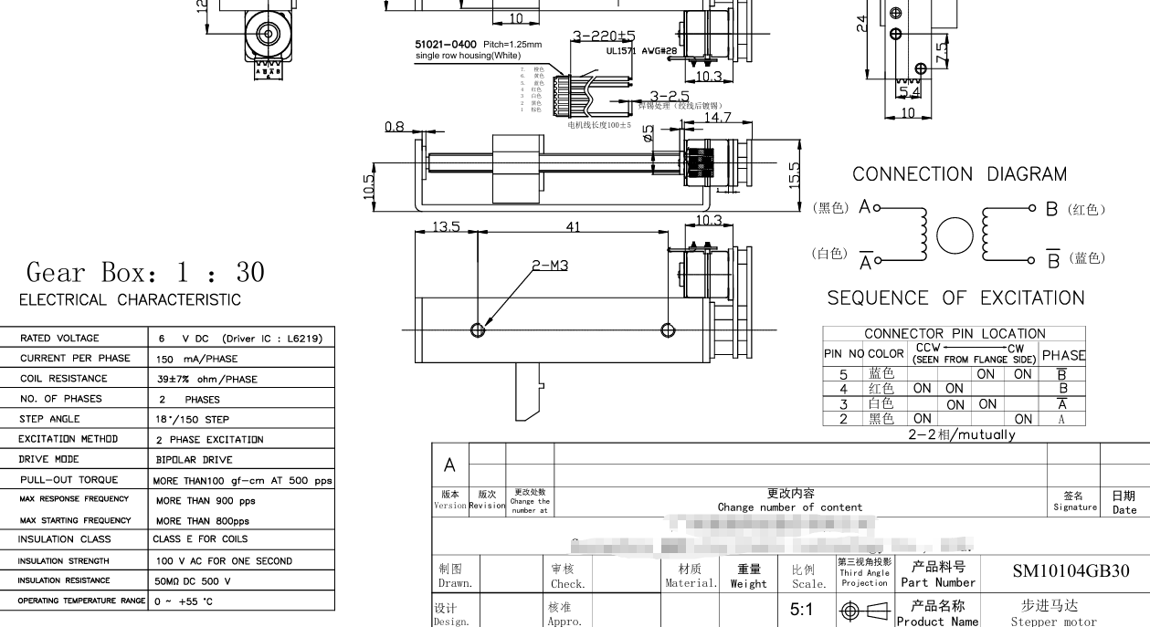

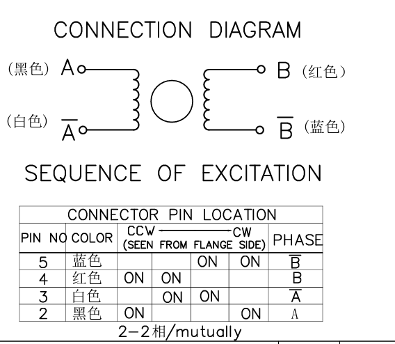

18/150 每个脉冲0.12度。每圈3000? 我用一个半步8拍的,跑3000脉冲,对不上文档了

u8 step_pulse[8]={0x38,0x28,0x2c,0x24,0x34,0x14,0x1c,0x18};       //脉冲
void automatic_reset()
  static u8 temp_index = 0;
    if(Automatic_Backward_flag)
        if(Pulse_frequency_continued <3000)
                      u8  P3_temp;
                      P3_temp = P3 & 0XC3;
                      P3= P3_temp | step_pulse[temp_index++];
                      if(temp_index >=7)
                        temp_index =0;
        if(++Pulse_frequency_continued >=3000)
            Automatic_Backward_flag =0;
        if(++Pulse_frequency_continued <= 1200)
                      u8  P3_temp;
                      if(temp_index >=8)
                        temp_index =0;
      else
搞好了,文档里的150是周期。8*150
