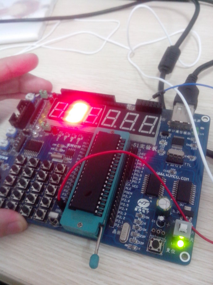

51单片机捕获(外部中断)程序
ID:65608 发表于 2014-9-12 01:00 | 只看该作者 回帖奖励 |倒序浏览 |阅读模式
#include<reg52.h>
#define uchar unsigned char
#define uint unsigned int
sbit dula=P2^6;
sbit wela=P2^7;
sbit Key =P3^2;
uchar a,b;
uint num=0;
uchar code table[]=
  0x3f,0x06,0x5b,0x4f,
  0x66,0x6d,0x7d,0x07,
  0x7f,0x6f,0x77,0x7c,
  0x39,0x5e,0x79,0x71
void delayms(uint);
void display(uchar shi,uchar ge)
  dula=1;
  P0=table[shi];
  dula=0;
  P0=0xff;
  wela=1;
  P0=0xfe;
  wela=0;
  delayms(5);
  dula=1;
  P0=table[ge] ;
  dula=0;
  P0=0xff;
  wela=1;
  P0=0xfd;
  wela=0;
  delayms(5);
void delayms(uint xms)
   uint i,j;
   for(i=xms;i>0;i--)
      for(j=110;j>0;j--);
void main ()
  EA=1;
  IT0=1;
  EX0=1;
  }  display(a,b);
void int0()interrupt 0
   num++;
  if(num>=100)
      num=0;
   a=num/10;
   b=num;
display(a,b);
