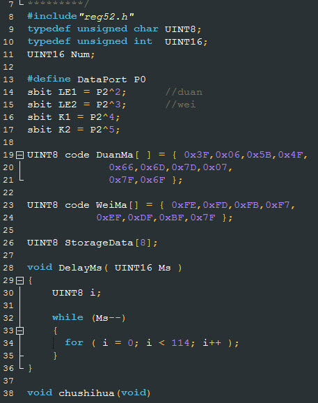

实验室仪器坏了,自己制作了一个,新手,因为仪器要求,精确度1ms,最大值9999ms,要求为接通开关K1开始计时;接通开关K2暂停计时并显示。

  1. /**********
  2. 功能:秒表
  3. MCU  : STC89C52     11.0592MHz
  4. 编译器: Keil C51 V4.22
  5. 描述: 精确度1ms,曹老师要求为接通开关K1开始计时;接通开关K2暂停计时并显示。
  6. 作者:NCUT_glx
  7. *********/
  8. #include"reg52.h"
  9. typedef        unsigned char UINT8;
  10. typedef unsigned int  UINT16;
  11. UINT16 Num;
  12.
  13. #define DataPort P0
  14. sbit LE1 = P2^2;                        //duan
  15. sbit LE2 = P2^3;                        //wei
  16. sbit K1 = P2^4;
  17. sbit K2 = P2^5;
  18. UINT8 code DuanMa[ ] = { 0x3F,0x06,0x5B,0x4F,
  19.                                      0x66,0x6D,0x7D,0x07,
  20.                                      0x7F,0x6F };
  21. UINT8 code WeiMa[] = { 0xFE,0xFD,0xFB,0xF7,
  22.                                    0xEF,0xDF,0xBF,0x7F };
  23. UINT8 StorageData[8];
  24. void DelayMs( UINT16 Ms )
  25. {
  26.                 UINT8 i;
  27.
  28.                 while (Ms--)
  29.                 {
  30.                         for ( i = 0; i < 114; i++ );
  31.                 }
  32. }
  33. void chushihua(void)
  34. {
  35.         TMOD |= 0x01;
  36.         TH0 =        (65536-917)/256;
  37.         TL0 =        (65536-917)%256;
  38.         ET0 =        1;
  39.         EA        =        1;
  40.         TR0=1;
  41. }
  42. void TIMER1(void) interrupt 1
  43.                 {
  44.                         TH0 =(65536-917)/256;
  45.                          TL0 =(65536-917)%256;
  46.                         Num++;
  47.                         if (Num==10000)
  48.                                 {
  49.                                         Num==0;
  50.                                 }
  51.                                         StorageData[ 0 ] = DuanMa[ Num / 1000 ];
  52.                                                            StorageData[ 1 ] = DuanMa[ ( Num % 1000 ) / 100 ];
  53.                                                            StorageData[ 2 ] = DuanMa[ ( ( Num % 1000 ) % 100 ) / 10 ];
  54.                                                            StorageData[ 3 ] = DuanMa[ ( ( Num % 1000 ) % 100 ) % 10 ];
  55.                 }
  56. void Display( UINT8 FirstBit, UINT8 Num )//UINT8 FirstBit:要显示的位;UINT8 Num:要显示的数码管的位数
  57. {
  58.                 UINT8 i;
  59.                 for( i = 0; i < Num; i++ )
  60.                 {
  61.                         DataPort=0;
  62.                            LE1 = 1;
  63.                            LE1 = 0;
  64.
  65.                            DataPort = WeiMa[ i + FirstBit ];
  66.                            LE2 = 1;
  67.                            LE2 = 0;
  68.
  69.                            DataPort = StorageData[ i ];
  70.                            LE1 = 1;
  71.                            LE1 = 0;
  72.
  73.                            DelayMs(1);
  74.                 }
  75. }
  76. void main (void)
  77. {
  78.         chushihua();
  79.         if(K1==0)
  80.         {
  81.                 while(1)
  82.                 {
  83.                         if (K2==0)
  84.                         {
  85.                                 TR0=0;
  86.                         }
  87.                         Display( 2, 4 );
  88.                 }
  89.         }
  90. }
  91.
  92.

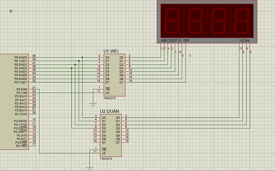

ID:75575 发表于 2015-3-29 10:40 | 只看该作者
所有资料都在这里啦,比较全,还有74hc373 锁存器资料以及自制protues 仿真图。
所有资料.zip
