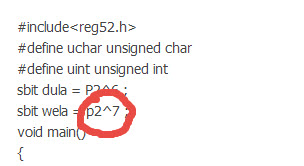

KEIL 显示wela x y p2 没有定义 什么原因
#include<reg52.h>
#define uchar unsigned char
#define uint unsigned int
sbit dula = P2^6 ;
sbit wela = p2^7 ;
void main()

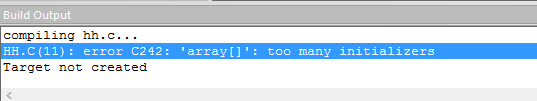

                uchar dtube[16]={0x3f,0x06,0x5b,0x4f,0x66,0x6d,0x7d,0x07,0x7f,0x6f,0x77,0x7c,0x39,0x5e,0x79,0x71}; //dula
                //            1    2    3    4    5    6
                uchar we[5]={0x7f,0xbf,0xdf,0xef,0xf7,0xfb}; //wela

楼主,刚才到keil 中运行了一下,两个问题:
1、p^2.7   应为P2^7   注意大小写;
2、如图2
