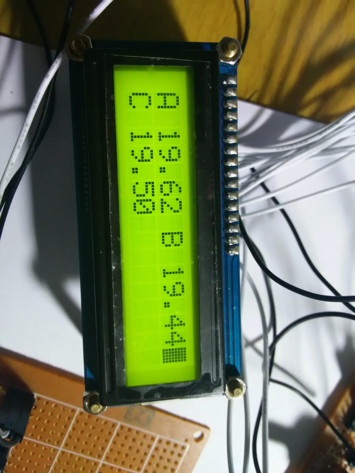

ID:77367 发表于 2015-4-19 02:41 | 只看该作者 回帖奖励 |倒序浏览 |阅读模式
  1. #include "1602.h"
  2. #define u8 unsigned char
  3. #define u16 unsigned int
  4. sbit dq=P3^7;
  5. float t;
  6. bit start;
  7. u8 id[8];
  8. u8 id1[8]={0x28,0xFE,0x27,0xFA,0x03,0x00,0x00,0x58};
  9. u8 id2[8]={0x28,0x82,0x0F,0xC7,0x05,0x00,0x00,0x7F};
  10. u8 id3[8]={0x28,0xA1,0xC1,0xC6,0x05,0x00,0x00,0x9F};
  11. void send_0()
  12. {
  13. dq=0;
  14. delay(30);
  15. dq=1;
  16. }
  17. void send_1()
  18. {
  19. dq=0;
  20. delay(0);
  21. dq=1;
  22. delay(30);
  23. }
  24. void ds18B20_send_cmd(u8 cmd)
  25. {
  26. u8 i,d;
  27. d=cmd;
  28. for(i=0;i<8;i++)
  29. {
  30. if(d&0x01)
  31. {
  32. send_1();
  33. }
  34. else
  35. {
  36. send_0();
  37. }
  38. d>>=1;
  39. }
  40. }
  41. u8 ds18B20_receive()
  42. {
  43. u8 i,d;
  44. for(i=0;i<8;i++)
  45. {
  46. d>>=1;
  47. dq=0;
  48. delay(0);
  49. dq=1;
  50. delay(0);
  51. if(dq==1)
  52. {
  53. d|=0x80;
  54. }
  55.     delay(35);
  56. }
  57. return d;
  58. }
  59. u8 ds18b20_start()
  60. {
  61. u16 tt;
  62. dq=0;
  63. delay(330);
  64. dq=1;
  65. delay(30);
  66. tt=0;
  67. while(dq==1)
  68. {
  69. tt++;
  70. if(tt>10000)
  71. {
  72. return 1;
  73. }
  74. }
  75. tt=0;
  76. delay(120);
  77. while(dq==0)
  78. {
  79. tt++;
  80. if(tt>10000)
  81. {
  82. return 2;
  83. }
  84. }
  85. return 0;
  86. }
  87. float read_n_18b20_temp(u8 *id)
  88. {
  89. u8 th,tl;
  90. u16 temp;
  91. u8 i;
  92. start=ds18b20_start();
  93. ds18B20_send_cmd(0x55);
  94. for(i=0;i<8;i++)
  95. {
  96. ds18B20_send_cmd(id[i]);
  97. }
  98. ds18B20_send_cmd(0x44);
  99. delay(2000);
  100. start=ds18b20_start();
  101. ds18B20_send_cmd(0x55);
  102. for(i=0;i<8;i++)
  103. {
  104. ds18B20_send_cmd(id[i]);
  105. }
  106. ds18B20_send_cmd(0xbe);
  107. tl=ds18B20_receive();
  108. th=ds18B20_receive();
  109. temp=th;
  110. temp<<=8;
  111. temp|=tl;
  112. if(temp&0x8000)
  113. {
  114. temp=~temp+1;
  115. }
  116. t=temp*0.0625;
  117. return t;
  118. }
  119. void main()
  120. {
  121. float t1,t2,t3;
  122. LCD_init();
  123. delay(1000);
  124. show_char(0x00,'A');
  125. show_char(0x08,'B');
  126. show_char(0x40,'C');
  127. while(1)
  128. {
  129. t1=read_n_18b20_temp(id1);
  130. t2=read_n_18b20_temp(id2);
  131. t3=read_n_18b20_temp(id3);
  132. delay(2000);
  133. show_float(0x02,t1);
  134. show_float(0x42,t2);
  135. show_float(0x0A,t3);
  136. }
  137. }
  138. //------------------------------------------
