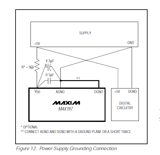

ÎÒ¿´¹©µçµç·ÄÇÀïÓиöÎÊÌ⣬ÒÔǰ×öµç·£¬¶¼ÊÇÄ£ÄâµØºÍÊý×ֵطֿª½Ó£¬×îºóÓÃ0Å·Ä·µç×è½ÓÆðÀ´£¬¿´µ½MAx197оƬÊÖ²áÉÏÃæµÄ½Ó·¨ÓеãÒÉ»ó£¬ÎªÊ²Ã´Ð¾Æ¬ÉϵÄÊý×ֵغÍÄ£ÄâµØÖ±½Ó½ÓÁËÆðÀ´ÄØ£¿Çó´óÉñ½â´ð£¬ÊDz»ÊÇ£¬ÔÚ½ÓÏß¾àÀëСµÄÇé¿öÏ¿ÉÒÔÕâô½Ó£¬ÒòΪÕâÑù¾àÀëС£¬µ¼Ïß¶Ì£¬¸ÉÈÅС£¬¿ÉÖ±½Ó½Ó£¿@Admin£¬Ð»Ð»£¡

Õâ¾ÍÊÇdatesheetÉÏÃæµÄͼ

²¼¾ÖºÏÀí£¬½ÓÔÚÒ»ÆðûÎÊÌâ¡£
