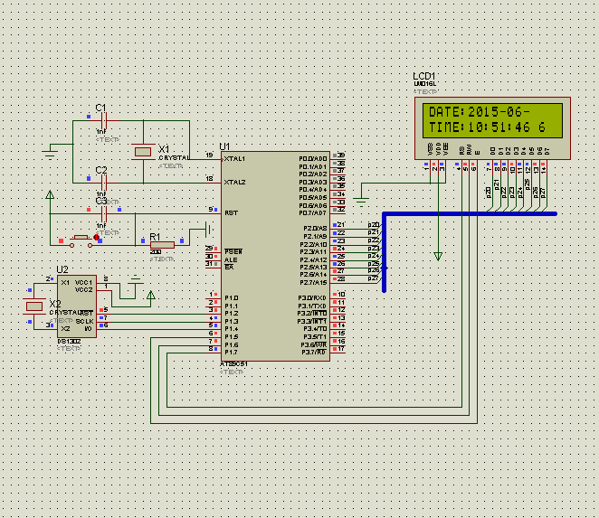

lcd1602+单片机万年历程序 不过好像日期不显示

  14. uchar datechar[]={"DATE:"};
  15. uchar timechar[]={"TIME:"};
  16. uchar datebuffer[10]={0x32,0x30,0,0,0x2d,0,0,0x2d,0,0};
  17. uchar timebuffer[8]= {0,0,0x3a,0,0,0x3a,0,0};

  113. void main(void)
  114. {
  115. uchar i;
  116. uchar data temp;
  117. delay(10);
  118. init();
  119. wc51com(0x80);
  120. for(i=0;i<5;i++) wc51ddr(datechar );
  121. wc51com(0xc0);
  122. for(i=0;i<5;i++) wc51ddr(timechar );
  123. v_W1302(0x8e,0);
  124. v_W1302(0x8c,0x15);
  125. v_W1302(0x8a,0x06);
  126. v_W1302(0x88,0x06);
  127. v_W1302(0x86,0x13);
  128. v_W1302(0x84,0x10);
  129. v_W1302(0x82,0x49);
  130. v_W1302(0x80,0x30);
  131. v_W1302(0x8e,0x80);
  132. while(1)
  133. {temp=
  134. uc_R1302(0x8d);
  135. datebuffer[2]=0x30+temp/16;datebuffer[3]=0x30+temp%16;
  136. temp=uc_R1302(0x8b);
  137. weekbuffer=0x30+temp;
  138. temp=
  139. uc_R1302(0x89);
  140. datebuffer[5]=0x30+temp/16;datebuffer[6]=0x30+temp%16;
  141. temp=
  142. uc_R1302(0x87);
  143. datebuffer[8]=0x30+temp/16;datebuffer[9]=0x30+temp%16;
  144. temp=
  145. uc_R1302(0x85);
  146. temp=temp&0x7f;
  147. timebuffer[0]=0x30+temp/16;timebuffer[1]=0x30+temp%16;
  148. temp=
  149. uc_R1302(0x83);
  150. timebuffer[3]=0x30+temp/16;timebuffer[4]=0x30+temp%16;
  151. temp=
  152. uc_R1302(0x81);
  153. temp=temp&0x7f;
  154. timebuffer[6]=0x30+temp/16;timebuffer[7]=0x30+temp%16;
  155. wc51com(0x85);
  156. for(i=0;i<8;i++)wc51ddr(datebuffer);
  157. wc51com(0xc5);
  158. for(i=0;i<8;i++)wc51ddr(timebuffer);
  159. wc51ddr(0x20);
  160. wc51ddr(weekbuffer);
  161. }
  162. }
