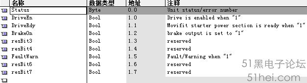

注意:兼容两个或三个过程数据字
PI1: 状态字 1
PI2: 状态字 2
Bit5   : 错误/警告 ="1"
Bit8-15: 错误位

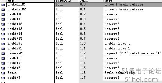

PO1: 控制字

note: compatible with 2 process data words (1PO/2PI)
PI1: Status word 1 (drive 1)
PI2: Status word 2 (drive 2)
Bit5   : Fault/Warning ="1"

PO1: CONTROL WORD

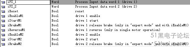

LAR1  P##_PI1_StatWord1           // copy status words into local variables
      L     #iPI_1
      T     LW [AR1,P#0.0]
      LAR1  P##_PI2_StatWord2
      L     #iPI_2
      T     LW [AR1,P#0.0]
      L     W#16#0                      // zeroes temporary variables
      LAR1  P##_PO1_CtrlWord
      T     LW [AR1,P#0.0]
      A     #iEnableM1                  // check preconditions to enable drive
      AN    #_PI1_StatWord1.FaultWarn
      =     #_PreconOK_M1
      A     #iEnableM2                  // check preconditions to enable drive
      AN    #_PI2_StatWord2.FaultWarn
      =     #_PreconOK_M2
      A     #_PreconOK_M1
      A     #iStartM1
      =     #_PO1_CtrlWord.EnableM1     // enable drive 1
      A     #iReverseM1
      =     #_PO1_CtrlWord.ReverseM1    // enable drive 1 "CCW"
      A     #_PreconOK_M2
      A     #iStartM2
      =     #_PO1_CtrlWord.EnableM2     // enable drive 2
      A     #iReset
      =     #_PO1_CtrlWord.Reset
      A     #iBrakeM1
      A     #_PreconOK_M1
      =     #_PO1_CtrlWord.BrakeRelM1
      A     #iBrakeM2
      A     #_PreconOK_M2
      =     #_PO1_CtrlWord.BrakeRelM2
      A     #_PI1_StatWord1.DriveEn
      A     #_PI1_StatWord1.DriveRdy

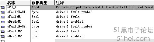

      =     #oDrvEnM1                   // drive enable indicator
      A     #_PI2_StatWord2.DriveEn
      A     #_PI2_StatWord2.DriveRdy
      =     #oDrvEnM2                   // drive enable indicator
      L     #_PI1_StatWord1.Status
      L     0
      ==I
      A     #iEnableM1
      AN    #_PI1_StatWord1.DriveRdy
      =     #_24V_Operation             // 24V operation (maintanence switch off)
      A     #_PI1_StatWord1.FaultWarn   // drive fault indicator
      O     #_24V_Operation             // 24V operation (maintanence switch off)
      =     #oFaultM1
      A     #_PI2_StatWord2.FaultWarn   // drive fault indicator
      =     #oFaultM2
      A     #oFaultM1
      JCN   NFL1
      JU    SFL1
NFL1: L     0
SFL1: T     #oFaultNoM1
      A     #oFaultM2
      JCN   NFL2
      L     #_PI2_StatWord2.Status
      JU    SFL2
NFL2: L     0
SFL2: T     #oFaultNoM2
      LAR1  P##_PO1_CtrlWord            // copy local variables into function outputs
      L     LW [AR1,P#0.0]
      T     #oPO_1
      SET
      SAVE
