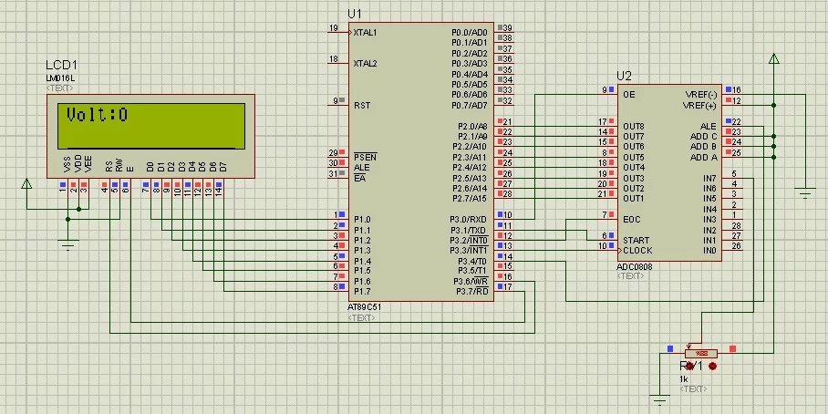

ADC0808 and LCD1602 for asm汇编 电路图+程序
ID:113276 发表于 2016-4-10 17:50 | 只看该作者 回帖奖励 |倒序浏览 |阅读模式
   RS  EQU P3.6
  E   EQU P3.7
  dat EQU P1
  OE  EQU P3.0
  ADCSTART  EQU P3.1
     CLOCK  EQU P3.3
       ALE  EQU P3.4
  ORG 0000H
  AJMP MAIN
  ORG 0003H
  SETB OE
  MOV R2,P2
  CLR  OE
  RETI
  ORG 000BH
  AJMP INIT0
  ORG 001BH
  CPL CLOCK
  RETI
  ORG 0050H
MAIN:   SETB EA
  SETB ET1
  MOV TMOD,#21H
  MOV TH1,#0FDH
  MOV TL1,#0FDH
  SETB TR1
  SETB EX0
  SETB PX0
  SETB IT0
  SETB ET0
  SETB PT0
  MOV TH0,#4DH
  MOV TL0,#0B0H
  SETB TR0
  ACALL SET1602
WWW: MOV dat,#80h
  ACALL W1602C
START:  MOV DPTR,#0200H
        MOV R4,#5
LOOP:   CLR A
        MOVC A,@A+DPTR
        MOV dat,A
  ACALL W1602D
  INC DPTR
  DJNZ R4,LOOP
  mov A,R2       //read
  MOV B,#51
  DIV AB         //Z
  MOV R1,B
        ADD a,#30h
  mov dat,a
  ACALL W1602D   //
  mov dat,#2eH
  ACALL W1602D   //"."
  MOV A,R1
  MOV B,#5
  DIV AB
  ADD A,#30H
  MOV dat,a
  ACALL W1602D
  MOV A,B
  ADD A,#30H
  mov dat,a
  ACALL W1602D
  SJMP WWW
SET1602: MOV dat,#38h
        ACALL W1602C
  MOV dat,#38h
        ACALL W1602C
  MOV dat,#38h
        ACALL W1602C
  MOV dat,#38h
        ACALL W1602C
  MOV dat,#06h
        ACALL W1602C
  MOV dat,#0Ch
        ACALL W1602C
  MOV dat,#01h
        ACALL W1602C
  RET
W1602C: CLR RS
        CLR E
  MOV R3,#03H
  DJNZ R3,$
  SETB E
  MOV R3,#07
  DJNZ R3,$
  CLR E
  NOP
  NOP
  RET
W1602D: SETB RS
        CLR E
  MOV R3,#02H
  DJNZ R3,$
  SETB E
  MOV R3,#5
  DJNZ R3,$
  CLR E
  NOP
  NOP
  RET
INIT0: CLR TR0
  CLR ALE
  CLR ADCSTART
  NOP
  NOP
  SETB ALE
  SETB ADCSTART
  NOP
  NOP
  CLR ALE
  CLR ADCSTART
  NOP
  NOP
  MOV TH0,#4DH
  MOV TL0,#80H
  SETB TR0
  RETI
       ORG 0200H
TAB1:  DB "Volt:"
       END
