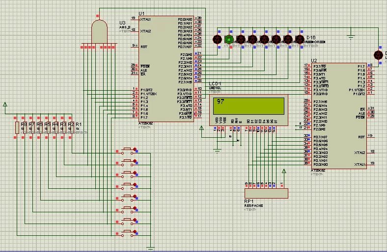

ID:113276 发表于 2016-4-10 17:54 | 只看该作者 回帖奖励 |倒序浏览 |阅读模式
51单片机串口通信程序带液晶显示 电路图在本帖最后,下面是发送端的程序
/*******************************************sent
#include<reg51.h>
#define uchar unsigned char
#define uint  unsigned int
uchar tt;
void delay(uint us)
  while(us--);
void send(uchar state)
  SBUF=state;
  while(TI==0);
   TI=0;
void SCON_init()
SCON=0X40;
TMOD=0x20;
PCON=0x00;
TH1=0xFD;
TL1=0xFD;
TI=0;
TR1=1;
void main()
char i;
SCON_init();
EA=1;
EX0=1;
IT0=1;
         tt=97;
  for(i=0;i<8;i++)
         P2=1<<i;
         delay(20000);
void sentdata() interrupt 0
send(tt/10);
//send((tt%100)/10);
send(tt%10);
             recv
#include<reg51.h>
sbit P17=P1^7;
sbit rs=P2^0;
sbit  e=P2^1;
uchar state,t1,t2,t3,t;
uchar tt[]="Today is-";
uchar yy[7][9]={"   Sunday","   Monday","  Tuesday","Wednesday"," Thursday",
                 "   Friday"," Saturday"};
void delay(uint us)
  while(us--);
void w1602(bit w,uchar dat)
          rs=w;
                                        P0=dat;
                                        e=0;
                                        delay(2);
                                        e=1;
                                        delay(4);
                                        e=0;
void init1602()
  w1602(0,0x38);
        w1602(0,0x06);
        w1602(0,0x0c);
        w1602(0,0x01);
void receive()
   while(RI==0);
   state=SBUF;
   RI=0;
void SCON_init()//
SCON=0X50;//
TMOD=0x20;//
PCON=0x00;//
TH1=0xFD; //
TL1=0xFD; //
RI=0;
TR1=1;
void main()
// char m;
init1602();
EA=1;
EX0=1;
IT0=1;
SCON_init();
   P17=~P17;
         delay(1000);
         t=10*t1+t2;
         w1602(0,0x80);
         w1602(1,0x30+t/10);
         w1602(1,0x30+t%10);
void recvdata() interrupt 0
        //char n;
  receive();
        t1=state;
        receive();
        t2=state;
