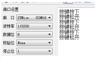

2.中断模式
第一步和上面相同,将接按键的引脚配置为上拉输入,然后配置相应中断,PA0对应外部中断0
功能:按键按下,点亮LED并向串口发送按键按下到PC,按键松开,关掉LED并发送按键松开
void key_interruptmode(void){     EXTI_InitTypeDef EXTI_InitStructure;       NVIC_InitTypeDef NVIC_InitStruct;     RCC_APB2PeriphClockCmd(RCC_APB2Periph_SYSCFG,ENABLE);  key_GPIO_Config();
    NVIC_InitStruct.NVIC_IRQChannel =EXTI0_IRQn;       NVIC_InitStruct.NVIC_IRQChannelPreemptionPriority = 0;     NVIC_InitStruct.NVIC_IRQChannelSubPriority = 1;    NVIC_InitStruct.NVIC_IRQChannelCmd = ENABLE;     NVIC_Init(&NVIC_InitStruct);
  SYSCFG_EXTILineConfig(EXTI_PortSourceGPIOA, EXTI_PinSource0);      EXTI_ClearITPendingBit(EXTI_Line0);      EXTI_InitStructure.EXTI_Line=EXTI_Line0;   EXTI_InitStructure.EXTI_LineCmd =ENABLE;   EXTI_InitStructure.EXTI_Mode=EXTI_Mode_Interrupt;  EXTI_InitStructure.EXTI_Trigger=EXTI_Trigger_Rising_Falling;
  EXTI_Init(&EXTI_InitStructure);}void EXTI0_IRQHandler(void){    if(EXTI_GetITStatus(EXTI_Line0))           {                  if(GPIO_ReadInputDataBit(GPIOA, GPIO_Pin_0))//按键按下                         {                                  GPIO_SetBits(GPIOB, GPIO_Pin_6);                                   printf("按键按下\n");                   //串口打印状态                           }                  else                                                                                //按键松开                             {                                  GPIO_ResetBits(GPIOB, GPIO_Pin_6);                                 printf("按键松开\n");                          }          }  EXTI_ClearITPendingBit(EXTI_Line0);}
