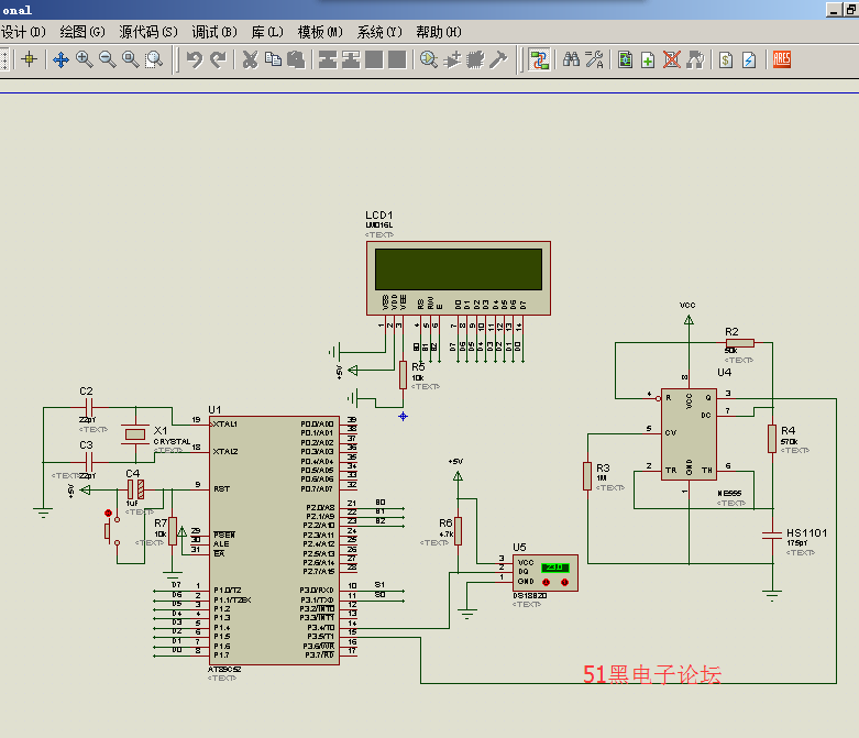

基于单片机的温度检测系统
基于单片机的温度检测系统
  1. #include<reg52.h>
  2. #include <absacc.h>
  3. #define uint unsigned int
  5. sbit rs=P2^0;
  6. sbit rw=P2^1;
  7. sbit en=P2^2;
  8. sbit DQ=P3^4;                //     18b20总线
  9. unsigned char  dat[9]={0};                        //温度
  10. unsigned char  shuju1[9]={0};         //湿度
  11. uchar code table1[17]={0x30,0x31,0x32,0x33,0x34,0x35,0x36,0x37,0x38,0x39,0x54,0x45,0x4d,0x50,0x2d,0x2e,0x20};        //温度调用
  12. uchar code table2[16]={0x30,0x31,0x32,0x33,0x34,0x35,0x36,0x37,0x38,0x39,0x53,0x48,0x49,0x25,0x2e,0x20};            //湿度调用
  13. /**************1602d调用函数*******************/
  14. void write_com(uchar com);
  15. void write_shuju(uchar shuju);
  16. void init();
  17. void delay(uchar z);
  18. /**************18b20调用函数**************/
  19. unsigned char reset(void);           //18b20初始化//
  20. void write(uchar dat);               //18b20写时序
  21. unsigned char read(void);            //18b20读时序
  22. void readtemperature(void);          //18b20读二进制16位温度
  23. void yanshi(unsigned int us);
  24. /****************hs1101调用函数*************************/
  25. void readfrequency(void);                        //        读频率函数//
  26. bit minrange=0;                                                //湿度下限标志位//
  27. bit maxrange=0;                                                //湿度上限标志位//
  28. bit T0Over=0;                                                //定时器结束标记
  29. unsigned char w,x,y;
  30. /******************主函数******************/
  31. void main()
  32. {
  33.         init();
  34.         while(1)
  35.         {
  36.                 readtemperature();
  37.                 write_com(0x80);
  38.                 write_shuju(table1[dat[0]]);
  39.                 write_com(0x81);
  40.                 write_shuju(table1[dat[1]]);
  41.                 write_com(0x82);
  42.                 write_shuju(table1[dat[2]]);
  43.                 write_com(0x83);
  44.                 write_shuju(table1[dat[3]]);
  45.                 write_com(0x84);
  46.                 write_shuju(table1[dat[4]]);
  47.                 write_com(0x85);
  48.                 write_shuju(table1[dat[5]]);
  49.                 write_com(0x86);
  50.                 write_shuju(table1[dat[6]]);
  51.                 write_com(0x87);
  52.                 write_shuju(table1[dat[7]]);
  53.                 write_com(0x88);
  54.                 write_shuju(table1[dat[8]]);
  55.                 readfrequency();
  56.         }
  57.
  58.
