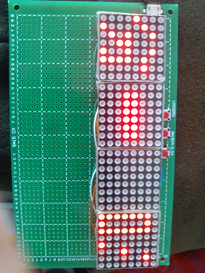

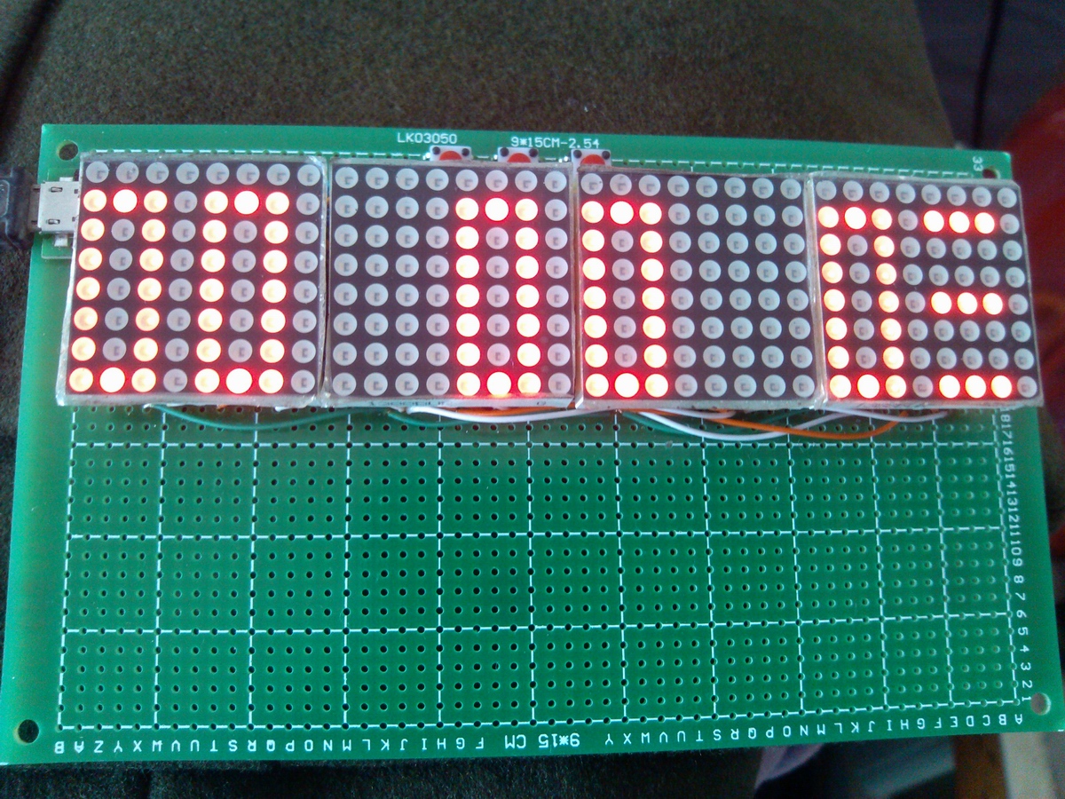

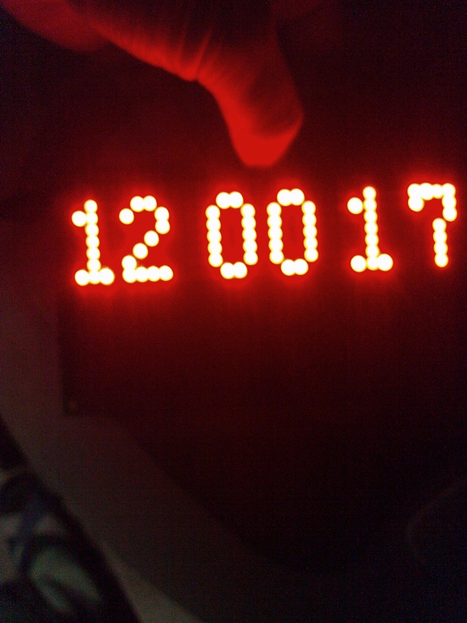

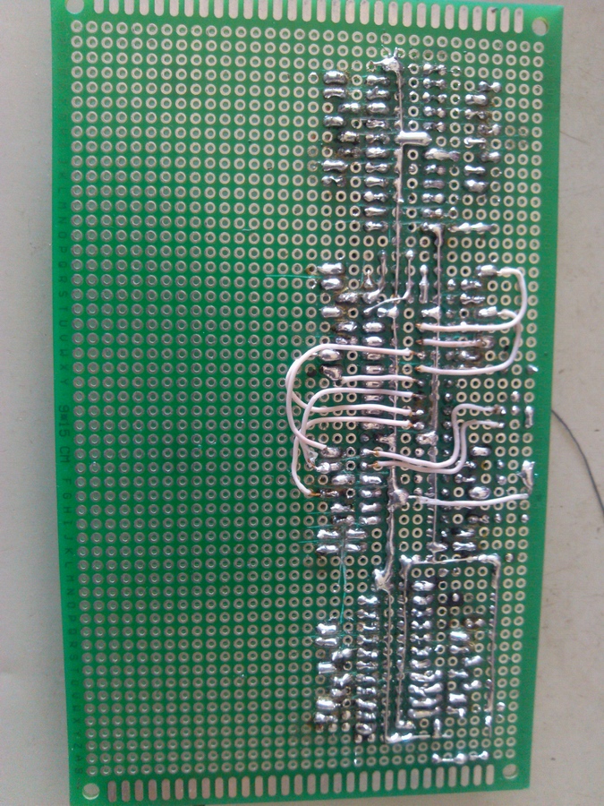

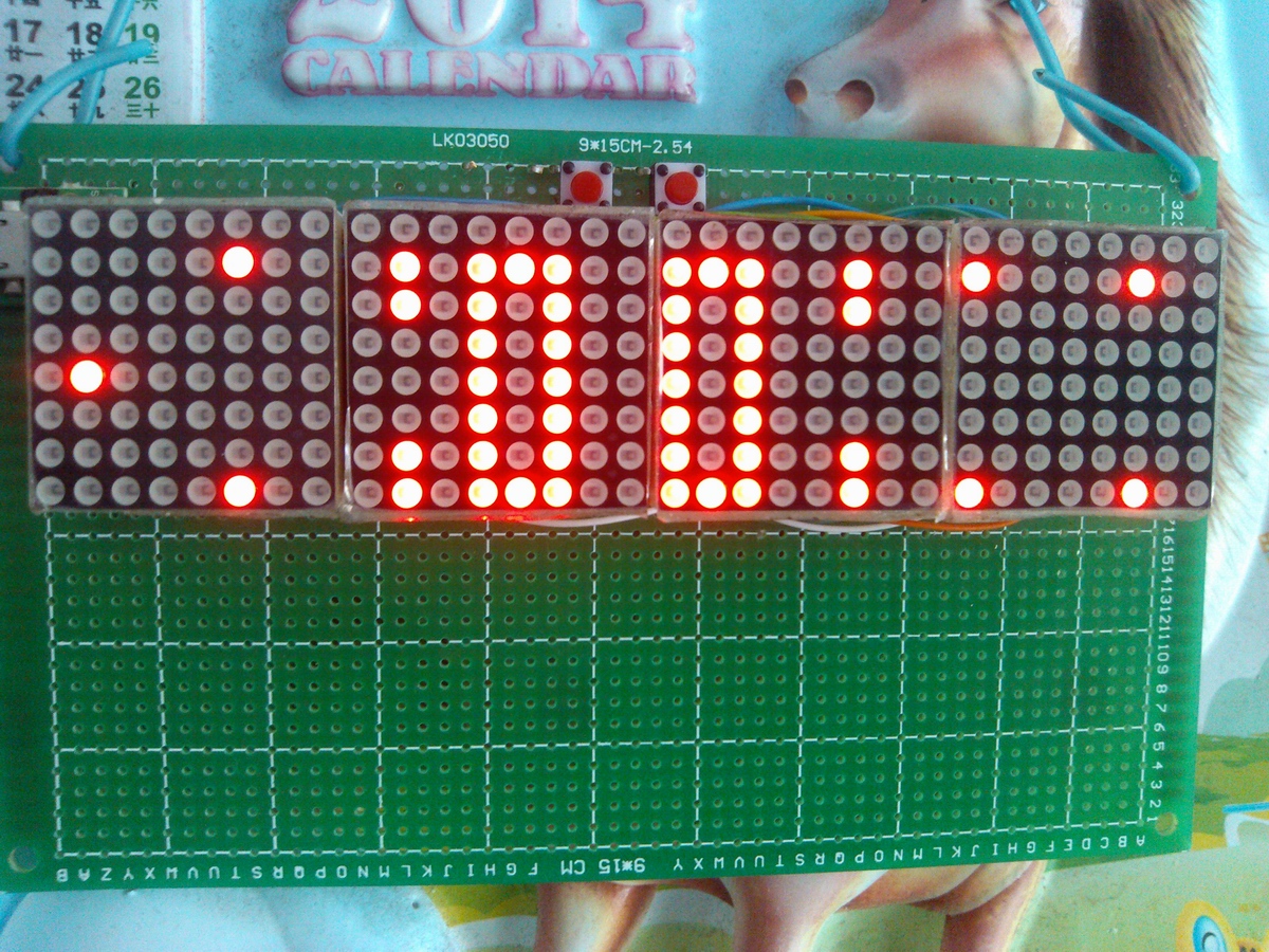

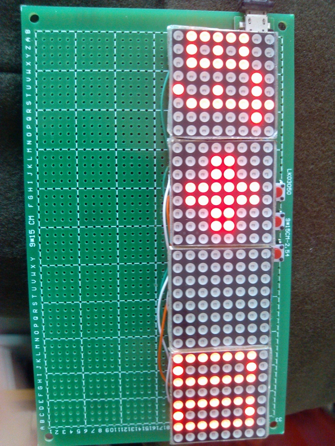

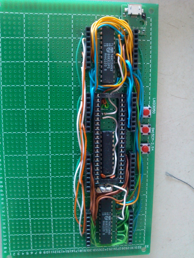

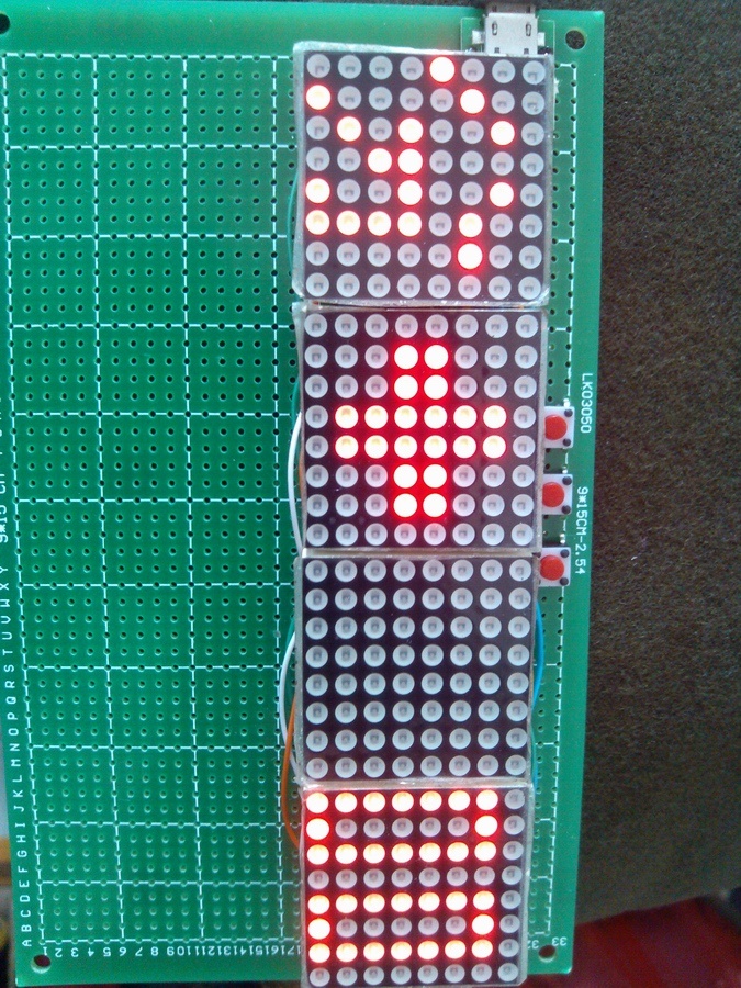

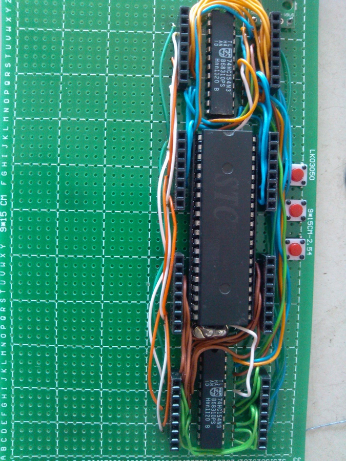

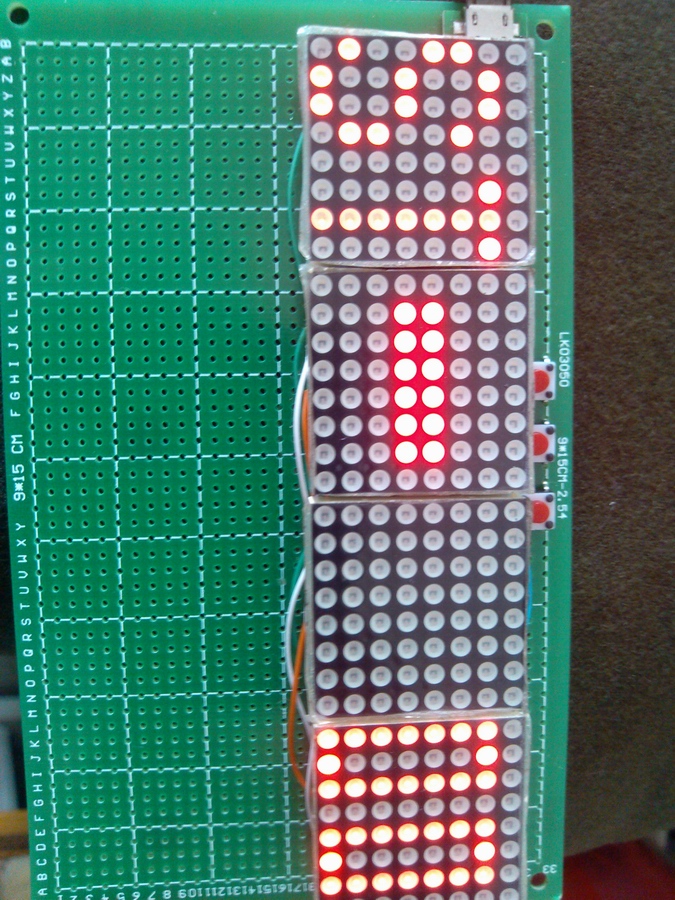

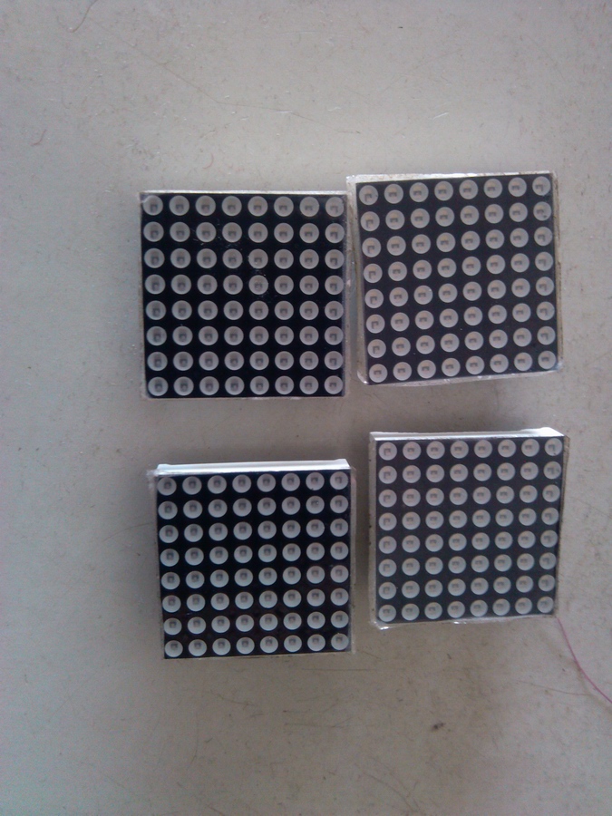

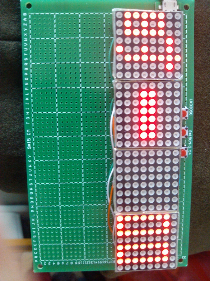

自制8x32点阵时钟,带误差调整,可用麻将筒子显示
ID:168911 发表于 2017-6-20 08:47 | 显示全部楼层 |阅读模式
IMG_20170620_084049.jpg IMG_20170617_102216.jpg IMG_20170617_101858.jpg IMG_20170619_194336.jpg IMG_20170617_102011.jpg IMG_20170617_102151.jpg IMG_20170617_102226.jpg IMG_20170617_102249.jpg IMG_20170617_101942.jpg IMG_20170617_101738.jpg IMG_20170617_101730.jpg IMG_20170617_101717.jpg 程序是网上8x16点阵滚动时钟修改而来,在此谢谢原创。
#include <REGX51.H> unsigned char sec=0,min=0,hou=12,st=0x00,timecount=0,oldP1=0xff,setting=0;
bit point=1,K1_old,K2_old;
unsigned char code dis_code[]=
{ 0x3E,0x41,0x41,0x3E,0x21,0x7F,0x01,0x00,//0与1
  0x23,0x45,0x49,0x31,0x22,0x41,0x49,0x36, //2与3
  0x1E,0x22,0x7F,0x02,0x72,0x51,0x51,0x4E, //4与5
  0x3E,0x49,0x49,0x26,0x60,0x40,0x4F,0x70,  //6与7
  0x36,0x49,0x49,0x36,0x32,0x49,0x49,0x3E,  //8与9
  0x3E,0x2A,0x3E,0x40,0x49,0xFE,0x40,0x00,        //时
  0x00,0x18,0x18,0x7E,0x7E,0x18,0x18,0x00,                   //+
  0x00,0x18,0x18,0x18,0x18,0x18,0x18,0x00,                        //-
  0x10,0x21,0x4A,0x0C,0x49,0x2F,0x20,0x00,        //分
  0x32,0x49,0x49,0x26,0x00,0x40,0x7F,0x40,        //st
