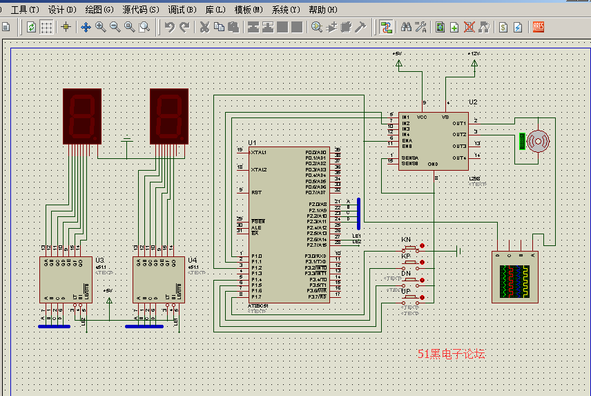

直流电机正反转及PWM调速的单片机仿真与源程序
直流电机正反转及PWM调速的proteus仿真原理图如下:
  1. #include<reg51.h>
  2. sbit In1 = P1^0;
  3. sbit In2 = P1^1;
  4. sbit ENa = P1^2;
  5. sbit up = P1^4;
  6. sbit dn = P1^5;
  7. sbit Kp = P1^6;
  8. sbit Kn = P1^7;
  9. sbit LE1 = P2^6;
  10. sbit LE2 = P2^7;
  11. bit p = 0;
  12. unsigned char  w = 70;
  13. void disp2(){
  14.         if(w == 100){
  15.
  16.            P2 = P2&0xf0;
  17.            LE2 = 0;LE2 = 1;
  18.            LE1 = 0;LE1 = 1; }
  19.         else{
  20.
  21.           P2 = (P2&0xf0        )| (w/10);
  22.            LE2 = 0;LE2 = 1;
  23.            P2 = (P2&0xf0)| (w%10);
  24.                 LE1 = 0;LE1 = 1;} }
  25. void k_up(){
  26.         unsigned char n = 0;
  27.
  28.         unsigned int t;
  29.         if(w!=100){        w++; }
  30.         else  w = 100;
  31.         disp2();
  32.         for(t=0;t<5000;t++);
  33.         while(up == 0){
  34.
  35.          for(t=0;t<2000;t++);
  36.          n++;
  37.          if(n==20) { n = 0;
  38.           if(w!=100) {        w++;}
  39.           else  w = 100;
  40.         disp2( );}}}
  41. void k_dn( ){
  42.         unsigned char n = 0;
  43.
  44.         unsigned int t;
  45.         if(w!=20)        w--;
  46.         else  w = 20;
  47.         disp2();
  48.         for(t=0;t<5000;t++);
  49.         while(dn == 0){
  50.
  51.          for(t=0;t<2000;t++);
  52.          n++;
  53.          if(n==20) { n = 0;
  54.           if(w!=20)
  55.
  56.           w--;
  57.           else  w = 20;
  58.         disp2();}}}
  59. void main(){
  60.    TMOD = 0x10;
  61.    TH0 = 256 - w*2;
  62.    TL0 = 256 - (100 - w) *2;
  63.         IP = 0x02;
  64.         IE = 0x82;
  65.         TR0 = 1;
  66.
  67.         disp2();
  68.         while(1){
  69.
  70.          if((up == 0)&(dn != 0))          k_up();
  71.          if((up != 0)&(dn == 0))          k_dn();}}
  72. void t0() interrupt 1{
  73.    if (w==100)        p=1;
  74.
  75.    else        p = ~p;
  76.    if(p ==0) TH0 = 256 - (100-w) *2;
  77.
  78.    else TH0 = 256 - w*2;
  79.    if ((Kp == 0)& (Kn !=0))  {
  80.       if(p==1) {
  81.
  82.                    ENa = 1;
  83. ……………………
  84. …………限于本文篇幅 余下代码请从51黑下载附件…………
