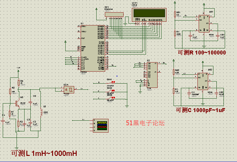

单片机RLC测量仪proteus仿真 RLC振荡电路设计
RLC振荡电路keil编译程序

  12. sbit A0=P1^4;
  13. #define LCD_data  P0
  14. uchar   code  table1[10]={"R=       R"};
  15. uchar   code  table2[10]={"C=      pF"};
  16. uchar   code  table3[10]={"L=      mH"};
  17. uchar code f_table[88]={13,14,15,16,17,        18,        19,        20,        21,        22,        23,        24,        25,        26,        27,        28,        29,        30,        31,        32,        33,        34,        35,        36,        37,        38,        39,        40,        41,        42,        43,        44,        45,        46,        47,        48,        49,        50,        51,        52,        53,        54,        55,        56,        57,        58,        59,        60,        61,        62,        63,        64,        65,        66,        67,        68,        69,        70,        71,        72,        73,        74,        75,        76,        77,        78,        79,        80,        81,        82,        83,        84,        85,        86,        87,        88,        89,        90,        91,        92,        93,        94,        95,        96,        97,        98,        99,        100};
  18. uchar code f_correct[88]={9,10,        11,        12,        12,        12,        13,        14,        15,        16,        17,        18,        18,        18,        19,        20,        21,        21,        22,        23,        24,        25,        25,        26,        26,        27,        28,        29,        29,        30,        30,        31,        32,        33,        33,        34,        35,        35,        36,        37,        38,        38,        39,        40,        41,        41,        42,        42,        43,        44,        45,        45,        46,        47,        48,        49,        49,        50,        51,        51,        52,        53,        54,        54,        55,        55,        56,        57,        57,        58,        59,        60,        60,        62,        62,        63,        64,        64,        65,        66,        66,        67,        67,        68,        69,        70,        71,        71,};
  19. uchar a6,a5,a4,a3,a2,a1;
  20. uchar flag;

  75.
  76. }
  77. void timer_init(void)  //定时器初始化
  78. {
  79.         TMOD=0X51;
  80.         PT0=1;     /*中断优先*/
  81.         TH0=0x3c;
  82.         TL0=0xb0;
  83.         TH1=0;
  84.         TL1=0;
  85.         ET0=1;
  86.         ET1=1;
  87.         TR0=1;
  88.         TR1=1;
  89.         EA=1;
  90. }

  147.
  148. }
  149. void correct(void)                        //误差修正函数
  150. {
  151.         uchar i,k;
  152.         unsigned long wucha;
  153.         if(cnt<100000)                   //100KHz以内的修正
  154.         {
  155.                 if(cnt>980&&cnt<2100)     cnt-=1;
  156.                 if(cnt>=2100&&cnt<3900)   cnt-=2;
  157.                 if(cnt>=3900&&cnt<4800)   cnt-=3;
  158.                 if(cnt>=4800&&cnt<5700)   cnt-=4;
  159.                 if(cnt>=5700&&cnt<8000)   cnt-=5;
  160.                 if(cnt>=8000&&cnt<9100)          cnt-=6;
  161.                 if(cnt>=9100&&cnt<10900)  cnt-=7;
  162.                 if(cnt>=10900&&cnt<11900) cnt-=8;
  163.                 if(cnt>=11900&&cnt<13000) cnt-=9;
  164.                 if(cnt>=13000&&cnt<=100000)
  165.                 {
  166.                         k=cnt/1000;
  167.                         for(i=0;i<88;i++)
  168.                         {
  169.                                 if(k==f_table[i])
  170.                                 {
  171.                                         cnt-=f_correct[i];
  172.                                 }
  173.                         }
  174.                 }
  175.
  176.
  177.         }
  178.         if(cnt>100000)
  179.         {
  180.                 wucha=(cnt/1000)*73065/100000;
  181.                 cnt-=wucha;
  182.         }
  183. }
  184. void main()
  185. {
  186.     timer_init();
  187.         lcd_init();
  188.         while(1)
  189.         {
  190.                    if(flag==1)
  191.                    {
  192.                         real_display();
  193.                         flag=0;
  194.                         }
  195.
  196.
  197.         }
  198.
  199. }
  200. void timer0() interrupt 1
  201. {
  202.         uchar timer0;
  203.
  204.         TH0=0x3c;          //50ms
  205.         TL0=0xb0;
  206.         timer0++;
  207.         if(timer0==20)
  208.         {
  209.                 TR1=0;          //关闭的计数器
  210.                 EA=0;
  211.                 cnt=TL1+TH1*256+f_cnt*65536;
  212.         //        correct();
  213.             //cnt1=(1e+9)/(2*0.693 *cnt)-20000/2;
  214.                 if(!R)
  215.                 {
  216. //                while(!R);
  217.                 cnt1=1000000/(0.2*0.693*cnt)-163-8;
  218.                 }
  219.                 else if(!C)
  220.                 {
  221.                 cnt1=1000000000/(0.693*3*510*cnt);
  222.                 }
  223.                 else if(!L)
  224. ……………………
