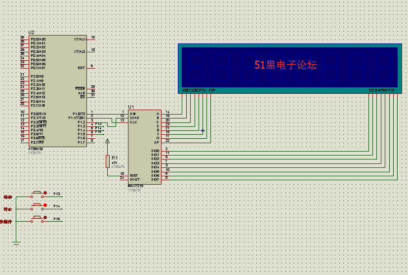

MAX7219单片机显示驱动程序 大作业-简单计步器
采用MAX7219芯片做的显示驱动代码
  1. #include "reg51.h"
  2. #define uint unsigned int
  4. sbit DIN = P1^0;
  5. sbit CLK = P1^1;
  6. sbit LOAD = P1^2;
  7. sbit StartKey = P1^3;
  8. sbit StopKey = P1^4;
  9. sbit StepKey = P1^5;
  10. uchar StartFlag=0;
  11. #define NoOp 0x00
  12. #define Digit0 0x01
  13. #define Digit1 0x02
  14. #define Digit2 0x03
  15. #define Digit3 0x04
  16. #define Digit4 0x05
  17. #define Digit5 0x06
  18. #define Digit6 0x07
  19. #define Digit7 0x08
  20. #define DecodeMode 0x09
  21. #define Intensity 0x0a
  22. #define ScanLimit 0x0b
  23. #define ShutDown 0x0c
  24. #define DisplayTest 0x0f
  25. #define ShutdownMode 0x00
  26. #define NormalOperation 0x01
  27. #define ScanDigit 0x07
  28. #define DecodeDigit 0xff
  29. #define IntensityGrade 0x0a
  30. #define TestMode 0x01
  31. #define TextEnd 0x00
  32. uchar DisBuffer[8]= {0,0,0,0,0,0,0,0};
  33. void delay(uint t)
  34. {
  35.         uint i;
  36.         while(t--)
  37.         {
  38.                 for(i=0; i<8; i++);
  39.         }
  40. }
  41. void SendChar(uchar ch)
  42. {
  43.         uchar i,temp;
  44. //        _nop_();
  45.         for(i=0; i<8; i++)
  46.         {
  47.                 temp=ch&0x80;
  48.                 ch=ch<<1;
  49.                 if(temp)
  50.                 {
  51.                         DIN=1;
  52.                         CLK=0;
  53.                         CLK=1;
  54.                 }
  55.                 else
  56.                 {
  57.                         DIN=0;
  58.                         CLK=0;
  59.                         CLK=1;
  60.                 }
  61.         }
  62. }
  63. void WriteWord(uchar addr,uchar num)
  64. {
  65.         LOAD=0;
  66. //        _nop_();
  67.         SendChar(addr);
  68. //        _nop_();
  69.         SendChar(num);
  70. //        _nop_();
  71.         LOAD=1;
  72. }
  73. void InitDisplay()
  74. {
  75.         WriteWord(ScanLimit,ScanDigit);
  76.         WriteWord(DecodeMode,DecodeDigit);
  77.         WriteWord(Intensity,IntensityGrade);
  78.         WriteWord(ShutDown,NormalOperation);
  79. }
  80. void main()
  81. {
  82.         unsigned long StepCount = 0;
  83.         uchar i;
  84.         InitDisplay();
  85.         WriteWord(DisplayTest,TestMode);
  86.         delay(3000);
  87.         WriteWord(DisplayTest,TextEnd);
  88.         while(1)
  89.         {
  90.                 if(StartKey == 0)
  91.                 {
  92.                         delay(100);
  93.                         if(StartKey == 0)
  94.                         {
  95.                                 StartFlag = 1;
  96.                                 for(i = 0;i < 8;i++)
  97.                                 {
  98.                                         WriteWord(Digit0+i,0);
  99.                                 }
  100.                         }
  101.                         while(!StartKey);
  102.                 }
  103.                 else if(StopKey == 0)
  104.                 {
  105.                         delay(100);
  106.                          if(StopKey == 0)
  107.                          {
  108.                                 StartFlag = 0;
  109.                          }
  110.                          while(!StopKey);
  111.                 }
  112.                 if(StartFlag)
  113.                 {
  114.                         if(StepKey == 0)
  115.                         {
  116.                                 delay(100);
  117.                                 if(StepKey == 0)
  118.                                 {
  119.                                         StepCount++;
  120.                                 }
  121.                                 while(!StepKey);
  122. ……………………
  123. …………限于本文篇幅 余下代码请从51黑下载附件…………
