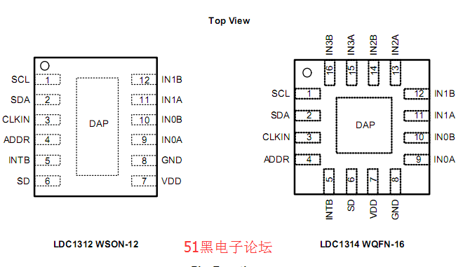

LDC1312,LDC1314芯片的引脚图:

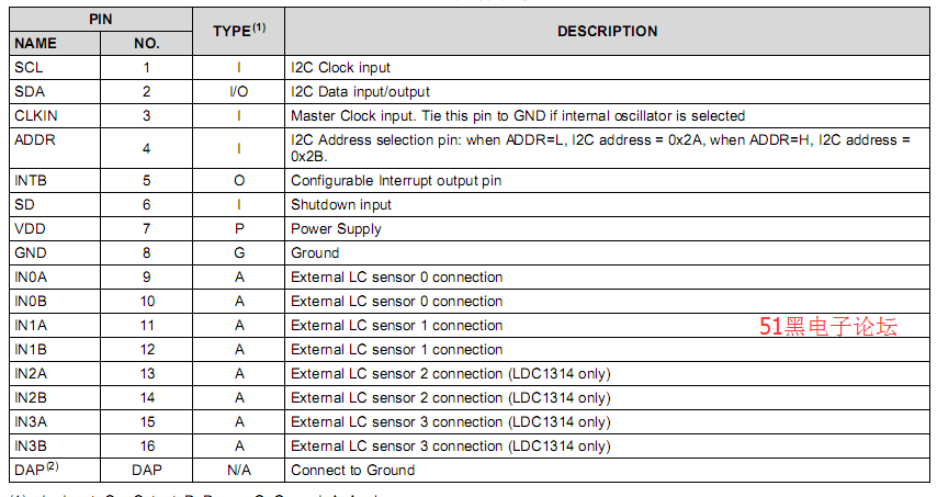

LDC1312,LDC1314管脚功能:
