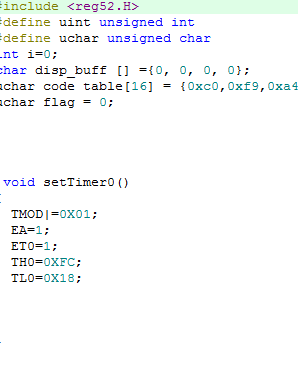

上实验课写的代码,附件里有c15的代码,proteus仿真图,自己写的。有错请指出。
  1. #include <reg52.H>
  2. #define uint unsigned int
  4. int i=0;
  5. char disp_buff [] ={0, 0, 0, 0};
  6. uchar code table[16] = {0xc0,0xf9,0xa4,0xb0,0x99,0x92,0x82,0xf8,0x80,0x90,0x88,0x83,0xc6,0xa1,0x86,0x8e};
  7. uchar flag = 0;
  8. void setTimer0()
  9. {
  10.         TMOD|=0X01;
  11.         EA=1;
  12.         ET0=1;
  13.         TH0=0XFC;
  14.         TL0=0X18;
  15.
  16.
  17.
  18. }
  19. void Timer0() interrupt 1
  20. {
  21.         TH0=0XFC;
  22.         TL0=0X18;
  23.         flag = 1;
  24. }
  25. void display(void)
  26. {
  27.     char code wei[] = {8, 4, 2, 1};//λѡ′úÂë
  28.     char i;
  29.     for (i = 0; i < 4; i++)
  30.          {
  31.
  32.                         TR0 = 1;
  33.
  34.         while(!flag){
  35.          P0 = table[disp_buff [i]];
  36.       P2 = ~wei[i];}
  37.         if(flag){
  38.         TR0 = 0;
  39.         flag = 0;         }
  40.
  41.                         P0 = 0XFF;
  42.
  43.
  44.
  45.           }
  46.           }
  47.
  48. uchar Keyscan(void)
  49. {
  50.     uchar i, j, temp, Buffer[4] = {0xef, 0xdf, 0xbf, 0x7f};
  51.     for(j = 0; j < 4; j++) { //Ñ-»·ËÄ′Î
  52.       P1 = Buffer[j];         //ÔúP1¸ßËÄλ·Ö±eêä3öò»¸öμíμçÆ½
  53.       temp = 0x01;            //¼Æ»®ÏèÅD¶ÏP1.0λ
  54.       for(i = 0; i < 4; i++) { //Ñ-»·ËÄ′Î
  55.         if(!(P1 & temp))      //′óP1μíËÄ룬½Øè¡1λ
  56.           return (i + j * 4); //·μ»Øè¡μÃμİ′¼üÖμ
  57.         temp <<= 1;           //ÅD¶ÏμÄ룬×óòÆò»Î»
  58.     } }
  59.     return 16;   }
  60.
  61.     void  main(void)
  62. {
  63.     unsigned char i, key;
  64.            setTimer0();
  65.     while(1)  {                   //ÎTÏTÑ-»·
  66.       display();                  //ÏÔê¾ò»±é
  67.       key = Keyscan();           //¶á3öò»±é¼üÅì
  68.       if (key < 16) {     //èç1ûóDè˰′¼ü
  69. //--------------------½øDD°′¼ü′|àí
  70.
  71.         disp_buff [3] = disp_buff [2];
  72.         disp_buff [2] = disp_buff [1];
  73.         disp_buff [1] = disp_buff [0];
  74.         disp_buff [0] = key;
  75. //--------------------′|àí½áêø£¬è¥μè′y°′¼üêí·Å
  76.
  77.                 for (i = 0; i < 20; i++)  display();        //Ëé¿aÏû¶¶
  78.         while(key != 16) {
  79.           key = Keyscan();
  80.           display();
  81.     } } }
  82. }
