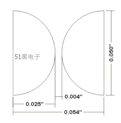

利用铜皮间隙做ESD防护的方法 焊盘间隙放电Spark Gaps
查看数: 5337 | 评论数: 0 | 收藏 0
发布时间: 2018-10-9 11:40
有时为了降低成本,利用铜皮做ESD防护,铜皮的制作。可以参考 An excellent way that I have found to protect inputs to electronics components from the very high voltages of ESD and EMI spikes is to use ...
