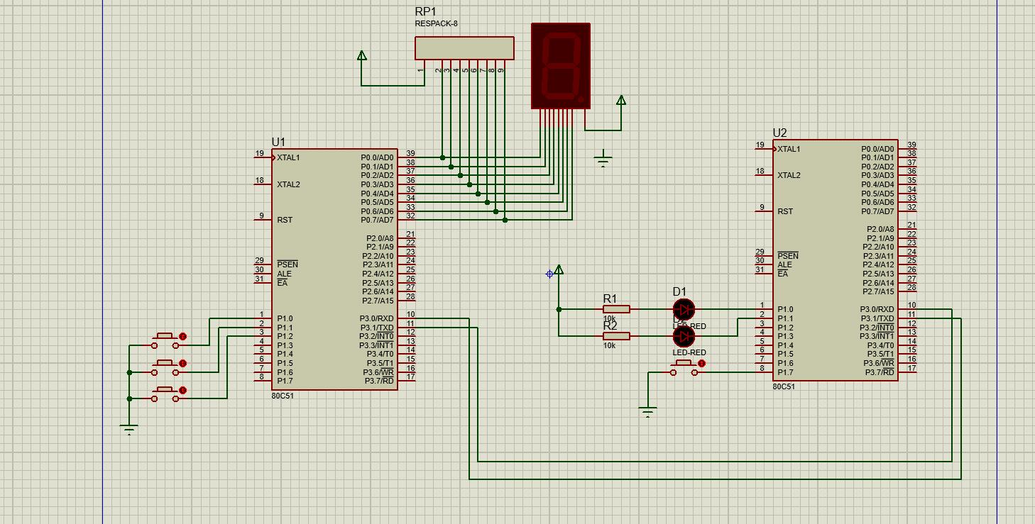

单片机串行控制led亮,程序没有报错,但是Proteus仿真不了,采用的是键盘扫,求大看看
查看数: 1835 | 评论数: 3 | 收藏 0
发布时间: 2021-12-11 00:15
求大佬帮忙,看一下,数据传输还是扫描问题 甲机子的程序: #include <reg51.h> #define uchar unsigned char #define uint unsigned int sbit k1=P1^0; sbit k2=P1^1; sbit k3=P1^2; unsigned char keyv ...

行哎你,整多机通讯?
ID:983158 发表于 2021-12-11 11:23
谢谢大佬改进,我去试试
ID:213173 发表于 2021-12-11 07:52
  1. #include <reg51.h>
  3. #define uint unsigned int
  4. //sbit k1=P1^0;
  5. //sbit k2=P1^1;
  6. //sbit k3=P1^2;
  7. unsigned char keyval;
  8. uchar code DSY_CODE[]={0x3f,0x06,0x5b,0x4f,0x66,0x6d,0x7d,0x07,0x7f,0x6f};
  9. void delay(uint xms)
  10. {
  11.         uint x,y;
  12.         for(x=xms;x>0;x--)
  13.                 for(y=110;y>0;y--);
  14. }
  15. void key_scan(void)
  16. {
  17.         if((P1&0x07)!=0x07)
  18.         {
  19.                 delay(10);
  20.                 if((P1&0x07)!=0x07)
  21.                 {
  22.                         switch(P1&0x07)
  23.                         {
  24.                                 case 0x06: keyval=1; break;
  25.                                 case 0x05: keyval=2; break;
  26.                                 case 0x03: keyval=3; break;
  27.                         }
  28.                         while(!((P1&0x07)!=0x07));
  29.                 }
  30.         }
  31. }
  32. void Putc_to_SerialPort(uchar c)
  33. {
  34.         SBUF=c;
  35.         while(TI==0);
  36.         TI=0;
  37. }
  38. void main()
  39. {
  40.         P0=0x00;
  41.         SCON=0x50;
  42.         TMOD=0x20;
  43.         PCON=0x00;
  44.         TL1=0xfd;
  45.         TH1=0xfd;
  46.         TR1=1;
  47.         IE=0x90;
  48.         keyval=0;
  49.         while(1)
  50.         {
  51.                 key_scan();
  52.                 switch(keyval)
  53.                 {
  54.                         case 1: Putc_to_SerialPort('X');keyval=0;break;
  55.                         case 2: Putc_to_SerialPort('A');keyval=0;break;
  56.                         case 3: Putc_to_SerialPort('B');keyval=0;break;
  57.                 }
  58.         }
  59. }
  60. void Serial_INT() interrupt 4
  61. {
  62.         if(RI)
  63.         {
  64.                 RI=0;
  65.                 P0=DSY_CODE[SBUF];
  66.         }
  67. }
