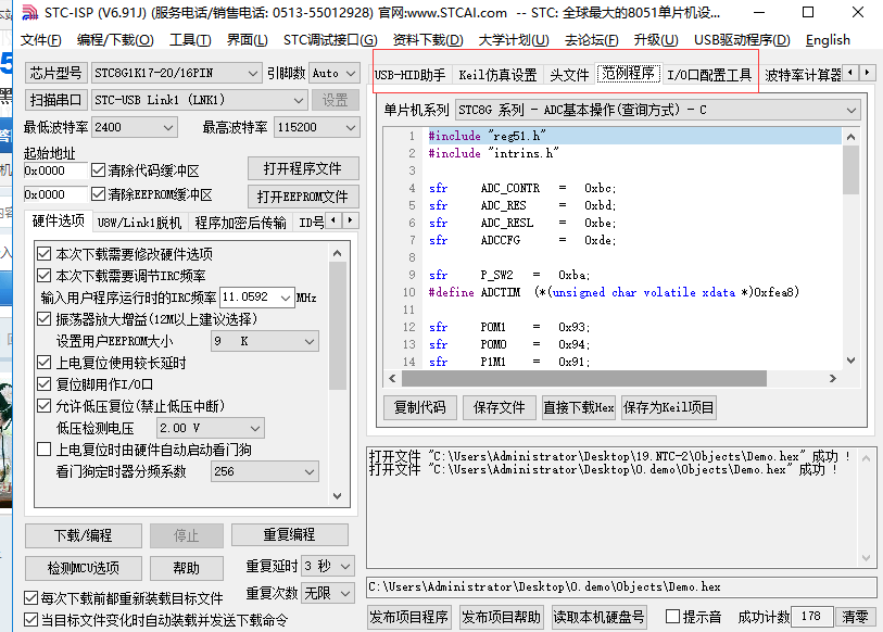

ID:1042619 发表于 2023-2-9 16:57 | 只看该作者
   感谢楼主精彩分享! 如有需要也可参考STC-ISP 6.91J一体化软件范例程序:下载STC8G系列ADC-基本操作(查询方式)范例代码
#include "reg51.h"
#include "intrins.h"
sfr     ADC_CONTR   =   0xbc;
sfr     ADC_RES     =   0xbd;
sfr     ADC_RESL    =   0xbe;
sfr     ADCCFG      =   0xde;
sfr     P_SW2   =   0xba;
#define ADCTIM  (*(unsigned char volatile xdata *)0xfea8)
sfr     P0M1    =   0x93;
sfr     P0M0    =   0x94;
sfr     P1M1    =   0x91;
sfr     P1M0    =   0x92;
sfr     P2M1    =   0x95;
sfr     P2M0    =   0x96;
sfr     P3M1    =   0xb1;
sfr     P3M0    =   0xb2;
sfr     P4M1    =   0xb3;
sfr     P4M0    =   0xb4;
sfr     P5M1    =   0xc9;
sfr     P5M0    =   0xca;
void main()
    P0M0 = 0x00;
    P0M1 = 0x00;
    P1M0 = 0x00;
    P1M1 = 0x00;
    P2M0 = 0x00;
    P2M1 = 0x00;
    P3M0 = 0x00;
    P3M1 = 0x00;
    P4M0 = 0x00;
    P4M1 = 0x00;
    P5M0 = 0x00;
    P5M1 = 0x00;
    P1M0 = 0x00;                                //设置P1.0为ADC口
    P1M1 = 0x01;
    P_SW2 |= 0x80;
    ADCTIM = 0x3f;                              //设置ADC内部时序
    P_SW2 &= 0x7f;
    ADCCFG = 0x0f;                              //设置ADC时钟为系统时钟/2/16
    ADC_CONTR = 0x80;                           //使能ADC模块
    while (1)
        ADC_CONTR |= 0x40;                      //启动AD转换
        _nop_();
        _nop_();
        while (!(ADC_CONTR & 0x20));            //查询ADC完成标志
        ADC_CONTR &= ~0x20;                     //清完成标志
        P2 = ADC_RES;                           //读取ADC结果
